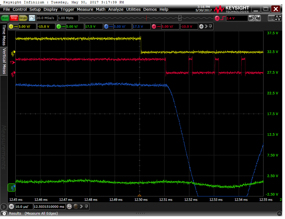

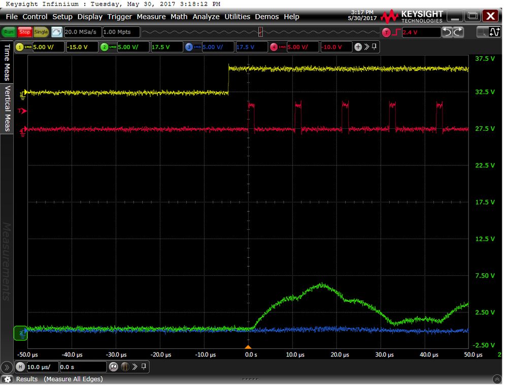

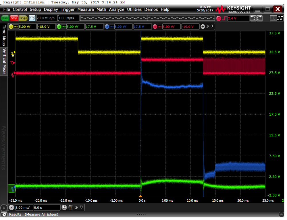

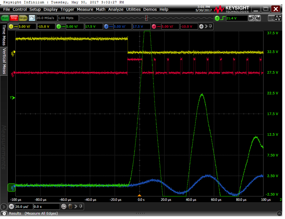

I am attaching a few screenshots.The yellow trace is a port toggling with every writing to MR2 and LER, the red trace is the PWM1.2 signal. Green and blue are motor voltages and not too useful at these timescales - I used them as trigger.
The following screen shows a single PWM cycle failure. The match value is being changed from 0 to 32. It can be seen that after the MR2/LER update, the PWM output stays high for one PWM cycle, then reverts to normal PWM operation with 32/256 duty cycle:

Here is an "update cycle" failure. The situation is the same, MR2 is changed from 0 to 32 - but this time, the PWM1.2 output stays high until MR2 is updated again 12.5 ms later (you can imagine that this causes a hard and loud bang from the drive):
After the next update, the PWM output again stays high for one single PWM cycle before reverting to the correct duty cycle. This screenshot is just a zoomed part of the previous one, at the next update (12.5 ms):
For comparison, here is a screenshot of a normal, correct PWM update:
Take care that the MR2/LER update occurs somewhere in the middle of the PWM timer cycle in this case. In the screenshots showing the two failure types (further above), it appears that the MR2/LER update is just hitting the internal PWM update process. Maybe that is causing these problems here. Of course these two timers/processes are asynchronous to each other, so this can happen at any time. Looking at the rather rare failure rate, it seems that the "critical time slot" for the update is rather small.
