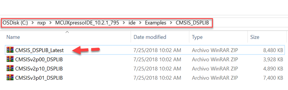

can i use fft function from cmsis dsp library. this library contains fft function. in the internet i found this library for suitable for lpc 13xx and 17xx series. it is suitable my lpc expresso 1549.

Please try using the CMSIS DSP for cortex M3,
This may be helpful to you:
CMSIS DSP Library Support
The library can be found in the Examples directory of the MCUXpresso install.
