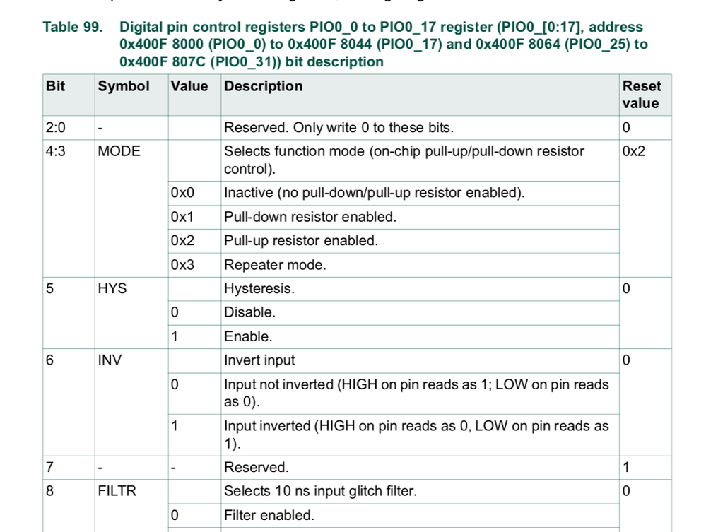

Ok, I have checked the sample code and it works on the same shield. What I have noticed in the sample code is that it is setting IOCON for pins in undocumented way ??

In the documentation 7th bit is defined as reserved while in the code it is set to digital mode enable. Which one is correct ?

Hello Sven,
Both are right, you can see the Reset value of bit 7 is 1, so there is no matter whether config like code.
