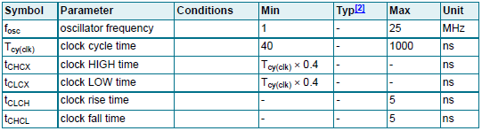

At external clock for the oscillator slave mode, its data sheet was written the specification as below.
But it doesn't define the base or threshold voltage of its specification.
I think that the base voltage is center of min/max voltage and their thresholds are +/-140mV from center because it needs swing voltage min 280mV.
Could you tell me which voltage is the base/threshold?
