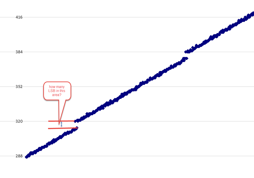

    Please tell me how you get your picture:
what is the horizontal axis unit, and vertical axis?
Actually, the slope of the wire is still not change, but it seems the x axis(horizontal axis) time is change, it caused your wire move upword.
So, please tell me how you get these data? save the adc data in the ADC interrupt or the timer interrupt? or any other else?
I do the testing on my LPC11U68 board with a fixed voltage:1.318V, test with multimeter.
Then use a flag in the timer interrupt to indicate the hardware timer happens. And save 100 datas in the while(1) like this:
The converted ADC data also have fluctuation. Tomorrow, I will find a ramp source to test it.
     Except the your picture's horizontal axis unit and test method, please also tell me how many LSB on your side in this picutre:

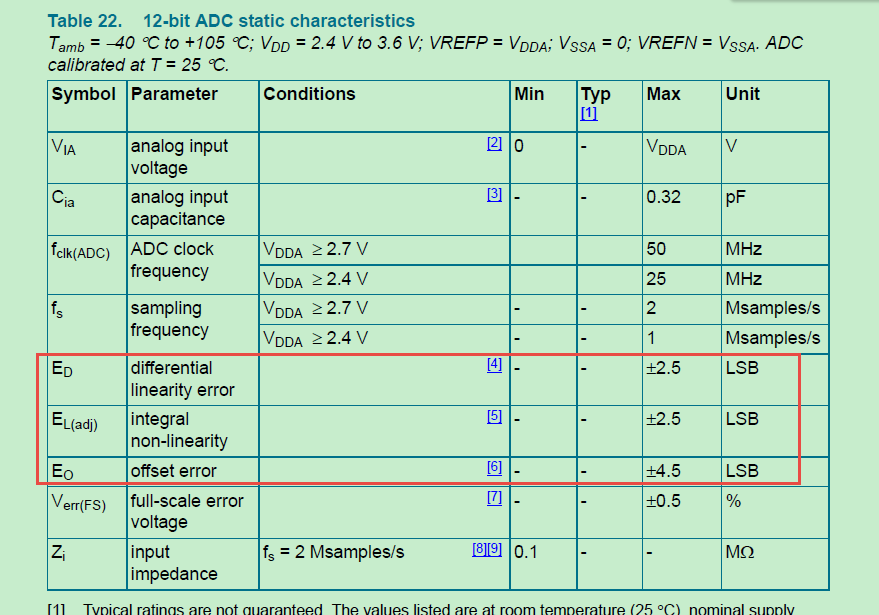

     From the datasheet, the LPC11U68 really have the LSB errors:
Please give me more details, I also need to check it with our AE department.

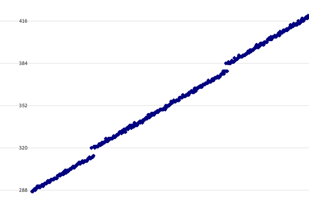

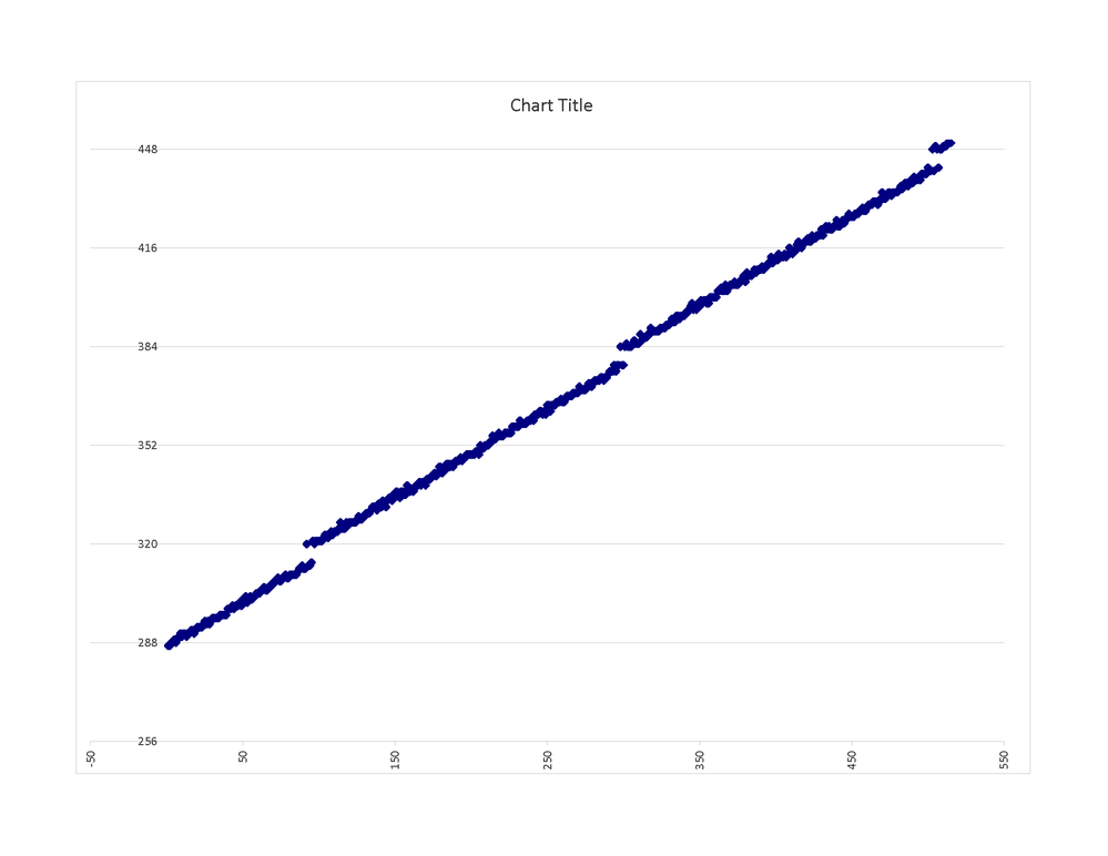

Here is an image of the collected data.  I am converting at 10 ksps.  I have a precision analog ramp feeding the input that is stepping at about 1/3 lsb per ADC conversion.  You can see that the jumps occur always at 8 counts below a 64 count boundary.  That is independent of input offset, sample rate, etc.  The ADC seems to have missing codes for the 8 counts prior to each 64 count boundary.  Notice also that there is a slope error on each segment.  We have seen this exact behavior on multiple samples of the LPC11 MPU.  Do you think that the chip should be performing better than this?  Is there any kind of software setup problem that could cause this?  Or is it possible that we have a bad batch of chips?
