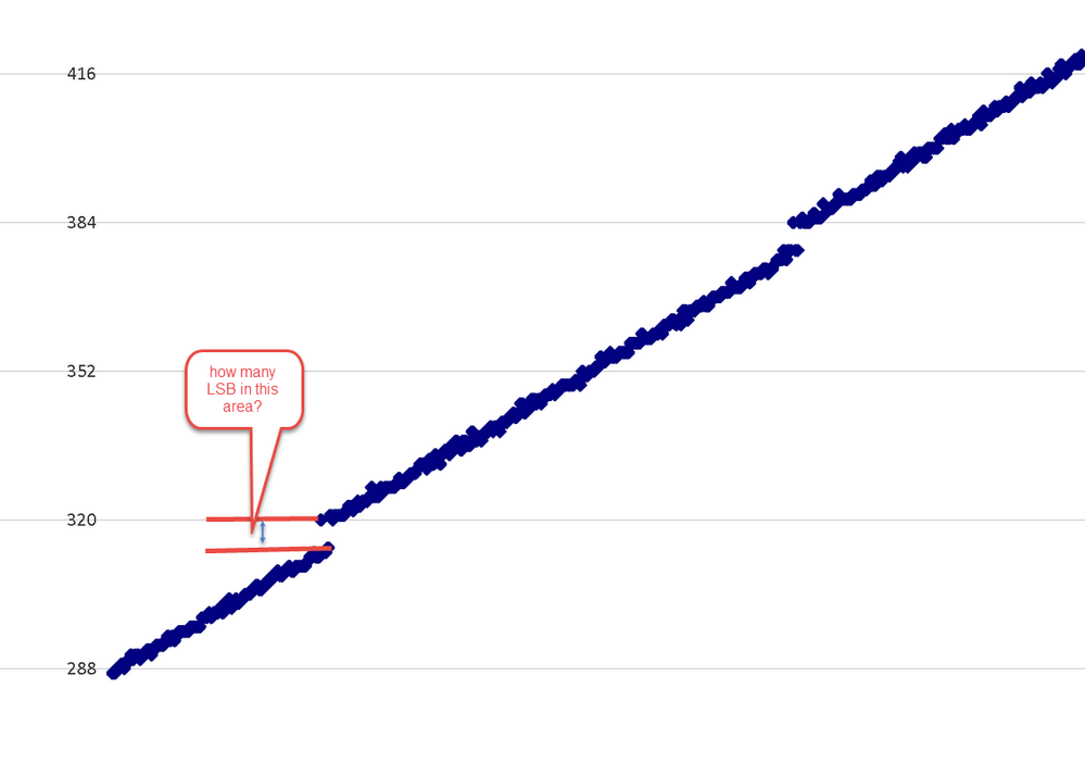

I'm using the LPC11U68, and am seeing rather bad ADC performance.  If I run a precision ramp into the input to collect the transfer function, I see that it plateaus at 8 counts before every 64 count boundary, and then jumps up to the boundary.  So for example, the ramp will be clean and one to one from 0 to 56, and then the ADC continues to return 56 for 8 steps, and then jumps to 64.  Same thing happens at 120 through 128, 184 through 192, etc.
This has been the case with multiple samples of the chip.
Has anyone encountered this?  Any ideas?  I am running the chip at 3.3V, Ref at 2.5V, and doing the ADC calibration operation per the user manual.

The analog input is created by dividing down and filtering a precision waveform created by custom equipment.  I cannot get you a scope capture of that waveform at this time.  But I can explain that it is a perfect staircase pattern, with the height of each step approximately 200 uV.  That is about 1/3 of an lsb for the ADC, which has a Vref of 2.5V.  The steps are occurring at 1 kHz and the sampling is at 1 kHz.  So there is an uncertainty about where the step edge occurs relative to the sample point, but the step edge is only 200 uV.
I think that if you set up such a test, you will see the same results.  This is a standard test of ADC linearity!  You can do the same thing with a precision programmable voltage source.
The problem is that this ADC seems to have terrible DNL.  I need to know if it is due to a software setup problem, a problem with a batch of chips that we bought, or a problem with all LPC11U68 chips.

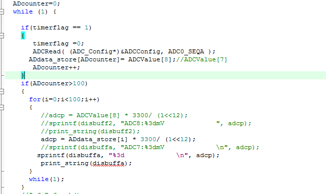

HI Marcschuman,
    Please tell me how you get your picture:
what is the horizontal axis unit, and vertical axis?
Actually, the slope of the wire is still not change, but it seems the x axis(horizontal axis) time is change, it caused your wire move upword.
So, please tell me how you get these data? save the adc data in the ADC interrupt or the timer interrupt? or any other else?
I do the testing on my LPC11U68 board with a fixed voltage:1.318V, test with multimeter.
Then use a flag in the timer interrupt to indicate the hardware timer happens. And save 100 datas in the while(1) like this:
The converted ADC data also have fluctuation. Tomorrow, I will find a ramp source to test it.
     Except the your picture's horizontal axis unit and test method, please also tell me how many LSB on your side in this picutre:

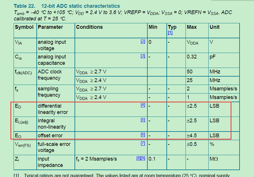

     From the datasheet, the LPC11U68 really have the LSB errors:
Please give me more details, I also need to check it with our AE department.

Here is an image of the collected data.  I am converting at 10 ksps.  I have a precision analog ramp feeding the input that is stepping at about 1/3 lsb per ADC conversion.  You can see that the jumps occur always at 8 counts below a 64 count boundary.  That is independent of input offset, sample rate, etc.  The ADC seems to have missing codes for the 8 counts prior to each 64 count boundary.  Notice also that there is a slope error on each segment.  We have seen this exact behavior on multiple samples of the LPC11 MPU.  Do you think that the chip should be performing better than this?  Is there any kind of software setup problem that could cause this?  Or is it possible that we have a bad batch of chips?
