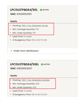

I am looking to use the LPC11U37FBD64/50EL as a drop-in replacement for the LPC11U37FBD64/501. Neither the datasheet nor user manual for the LPC11U3x series mention the /50EL variant.
My main questions are:
  1. Does the /50EL variant have USB bootloader support?
  2. Does the /50EL variant have the 2kB of USB SRAM at 0x20004000?
1,414件の閲覧回数
Hi @znickerson
Thanks for your patience.
" The only difference between 50EL and 501 variants is the packing type:  501 uses single tray, 50EL uses multiple tray'
 LPC11U37FBD64/50EL has USB bootloader support, also have the 2kB of USB SRAM ."
Thanks you.
Alice

znickerson
Thanks for the quick clarification, much appreciated!
