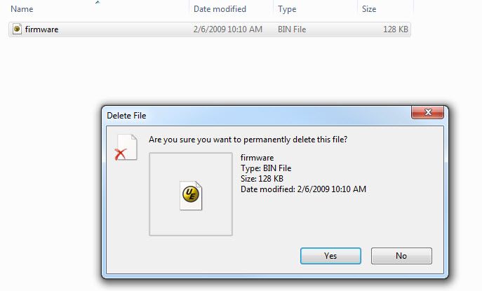

Hi, I have an LPC11U35 with an bug in the firmware that have made the device stop responding. Now I need to find a way to flash the device again. The problem is that it's already an mass produced item but I do have all documentations for the pcb. Is there anything I can do to make it appear as a MSD? Or a way to connect SWD or JTAG to it?
If I have to solder to the chip that is okey.
Br,
Jakob

You need to pull the PIO0_1 low and pull the PIO_3 high to force the MCU enter the USB ISP, then you can update the application code via the demonstrated steps above.

The LPC11U3x series support USB ISP and UART ISP modes, if enters the USB ISP mode, the MCU will be enumerated as a Mass Storage Class Device when USB port connects a USB host interface.
You can also use the Flash Magic to program the LPC11U3x when choose the UART ISP modes, and you can learn the more detailed information via the link below.

Hi Jakob Berglund,
As you mentioned above, your board doesn't have the SWD or JTAG interface, however the USB port is available.
So you can follow the these steps to program the flash.
1. First, force the MCU enter the USB ISP by referring to the LPC reference manual, and the chip will be enumerated as a driver.
2. Double click the driver, you will find a bin file whose name is firmware, then copying a new application executable file to the driver after deletes the firmware file. After that, the chip is programmed by the new executable file.

jakobberglund
I have tried to force the MCU into USB ISP by looking at this manual http://www.nxp.com/documents/user_manual/UM10462.pdf. But I do not understand what I have to do. I have looked at page 396 of that manual and I know pin PIO0_3 is high. But I think it ends up in executing code because it think that the code is valid.
Have I misunderstood something? I am new to the LPC chips.

jeremyzhou
Hi Jakob Berglund,
Thanks for your reply.

jakobberglund
Thanks a lot for your help! I managed to fixed my broken devices now :smileyhappy: You saved me a lot of money and time.
