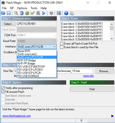

The LPC11U3x series support USB ISP and UART ISP modes, if enters the USB ISP mode, the MCU will be enumerated as a Mass Storage Class Device when USB port connects a USB host interface.
You can also use the Flash Magic to program the LPC11U3x when choose the UART ISP modes, and you can learn the more detailed information via the link below.

jakobberglund
Hi thanks for your quick answer!
I installed the Flash Magic program. But I do not understand if I need any additional hardware or if I should be able to flash it over USB. And if it should be possible to flash it over USB what interface should i use?pastedImage_1.png
As I said the chip is already installed in a product. So if I could flash over only USB that would be very good. But if not what hardware to I need and how can I connect it to my chip. The designer of the PCB did not add easy connections for SWD or JTAG :smileysad: but I could probably solder it in anyway if needed.

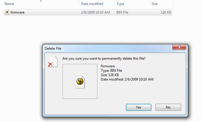

1. First, force the MCU enter the USB ISP by referring to the LPC reference manual, and the chip will be enumerated as a driver.
2. Double click the driver, you will find a bin file whose name is firmware, then copying a new application executable file to the driver after deletes the firmware file. After that, the chip is programmed by the new executable file.
