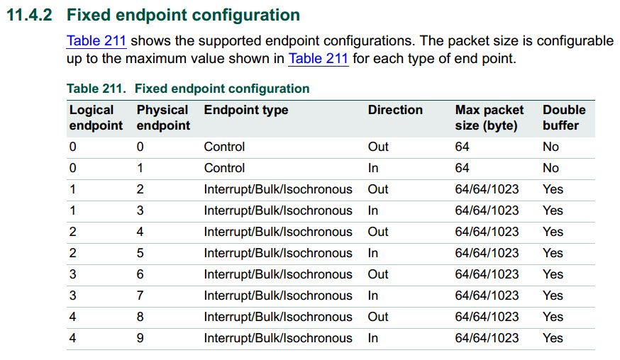

I am trying to get multiple virtual COM ports on a single LPC11U35.
Windows detects the device, agrees that there are 2 COM ports (and a mouse, which is rudimentary from the example code). The COM port that came with the example works well. I modified the code to get the second one working, but it fails at configuration (opening the port). The example project I used was "nxp_lpcxpresso_11u14_usbd_lib_composite" from "lpcopen_v2_00a_lpcxpresso_nxp_lpcxpresso_11u14.zip"
Using breakpoints, I looked up the path what a working port should follow. I have determined that when opening the port, the working one goes all the way to its "VCOM_SetLineCode" function, however the failing one does not get past "USB_EndPoint0" ("USB_EvtOutHandler" never gets called). Here is a screenshot of the working chain:
Parts of code that may be of interest:

jeremyzhou
Hi Jens Dender,
After dig deeper into the issue, I think the LPC11U35 can't achieve the application: HID +CDC+CDC, as the LCP11U35 has the limitation of the endpoint number (Fig 1).
So I'd highly recommend you to choose the LPC176x/5x instead of the LPC11U35 and LPC176x/5x can support 16 endpoints.
                                                                        Fig 1
Hope this is clear.

jeremyzhou
Hi Jens Dender,
                                                                        Fig 1
Hope this is clear.
Ping

jeremyzhou
Hi Jens Dender,
Thanks for your reply.
After review your demo, I have some suggestions for you.
1. You would see the CDC class should involve two interfaces and two endpoints at least, therefore the composite demo needs 5+1 endpoints to achieve the 2 CDC class + 1 HID class at least. For the composite demo, I'd like to exemplify the amended descriptor below.
 * USB FSConfiguration Descriptor
 * All Descriptors (Configuration, Interface, Endpoint, Class, Vendor)

2. You need to consider the bug of the ROM driver as the errata demonstrates.
3. I think you need to get the idea of the process of window handles a composite device, I think you may need to modify the INF file to suit the new USB composite device and the attachment will help you a lot.
Ping
