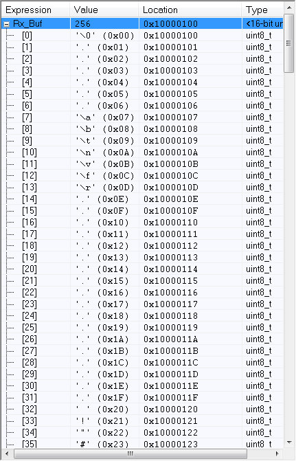

I did a test with the OM13093 LPCXpresso board for LPC11C24 using <lpcopen_v2_00a_keil_iar_nxp_lpcxpresso_11c24> software package with [periph_ssp] demo.
For I only have one OM13093  board on hand, I short connect the LPC11C24 PIO0_8(MISO) & PIO0_9(MOSI) together.
I disable the LOOPBACK_TEST macro definition.
After the demo code run, I could find Rx_Buf array with Tx_Buf array value:
The SPI analyzer also shows the MOSI with the same data of MISO:
I think you could refer this [periph_ssp] demo as a start point.
