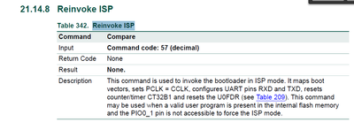

OK This is probably impossible, but is there a way when running code, to jump to the rom bootloader and get it into USB Connect, to easily do an upgrade from the USB port?

It can jump to UART_ISP mode through "Reinvoke ISP":
Alice

THANKS!!!!!
