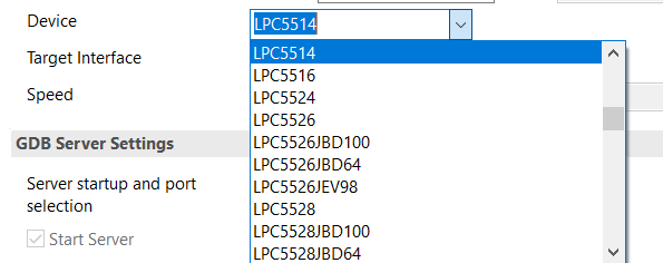

I have a Jlink V10 and it can support LPC54618 well in a previous project. But when try to use it to debug the LPC5514 in another project, and give the tips: "The selected device LPC5514 is unknow to this version of the J-Link software." (as the attached picture 1). And this was confirmed by checking the support device list, LPC5514 not in the list.(as the attached picture 2, other device such as LPC5516 also not supported).
Then I want to know how to solve this problem?

Hello weilin ge ,
Which version of MCUXpresso IDE do you used?
Please use the latest MCUXpresso IDE v11.1.1.
I check on my side, it support lpc54114.

geweilin
The IDE version I used when I asked questions was 11.1.0.
Now I have followed the latest version of 11.1.1.
The problem changed, but it still failed.

Hello Weilin,
Jlink should support LPC5514.
Please check the power of your chip, because LPC-link2 can give power to target when JP2 is closed,
you can make it open to have a test.

geweilin
Thank you for your support! The problem has been solved because the JLINK adapter board I used (20pin to 10PIN) has misconnected port. There is no problem after replacing the adapter board.jlink_adapter.jpg
