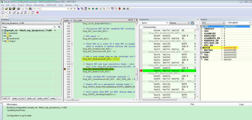

I have debug the periph_rtc project, after set the MATCH data, then read it in the register, I can get the correct result:
You can find it from my debug result:
Kerry
