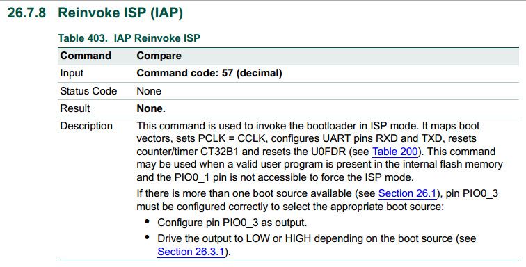

Dear All,
I'm using a LPC11C24 (with integrated CAN bus transceiver) and I need to write a function to go to CAN ISP mode from my user code.
Is this possible and how ?

gfa
Thank you for your message,
But for sure ISP is supported by CAN in the LPC11C24, I did software download many times with Flash magic tool (free).
Unfortunately, the only way I know to set the lpc in ISP mode is by a hardware reset while I need to do it by CAN (by user code).

jeremyzhou
Hi Guillaume FANJAS,
Yes, the LPC11C24 supports the UART ISP and CAN ISP routines.
Sorry, I miss the information.
You can use the IAR command to force the LPC11C24 enter into the ISP mode.
