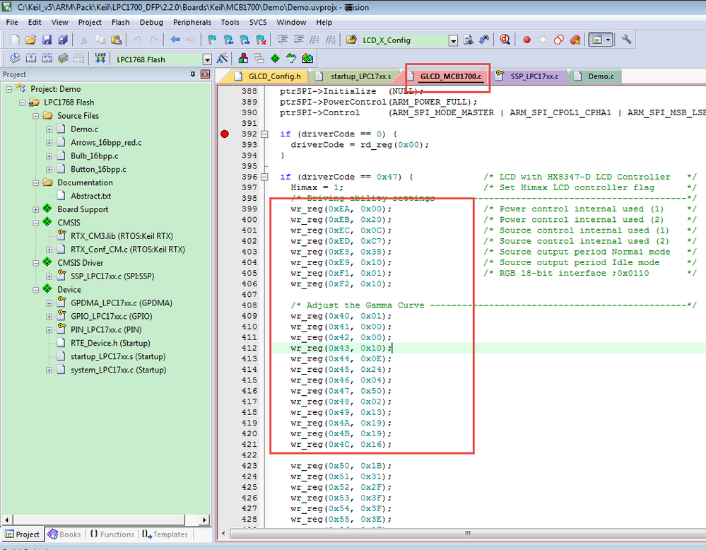

for the MCB1700 from Keil with LPC1768 and LCD-TFT 240x320 pixel color graphics display, i tried to compile and flash the BSP bellow. To compile the project without errors, i have to set the compiler to GNU C90 standard. After flashing the project to the eval board, the program hangs in an infinite loop in the gui delay loop. After fixing this behavior, the code was still not able to show any picture on the display.
Does anyone have a hint, what i have to change? I also tried to adapt a version from Keil to use in LPCOpen IDE, but the result was the same. I am even not able to print a simple "hello world" with the emWin library.

Hi Kapuzzze,
  Could you tell me the number on your LCD?
  Take an example, my board with  LCD number  A774A-22 -P120814 -4074, this is not working.
  Another board with LCD number : A774A-43-P101210-4072, this board can work.
  After a lot of test, we find it should caused by the LCD type, the sample code is for the  LCD type(P101210) which may different from you. As I know, MCB1700 have at least 2 LCD types in the past days, I already check it with the Keil engineer, what the difference between these LCDs, and waiting for their reply.

Hi Kapuzzze,
    After checking carefully, your problem is really caused by the different LCD type.
  mWin 5.14 BSP version 1.0 for MCB1700 is for the LCD type with P101210, not P120814, the control command is totally not the same.
  So, maybe you should need to modify the code by yourself,  after I contact with MDK, they also don't have the datasheet about it.
  But I found in the sample code from MDK IDE, demo project, there has some drivers for the LCD with P120814.
  You can find this project in install path:C:\Keil_v5\ARM\Pack\Keil\LPC1700_DFP\2.2.0\Boards\Keil\MCB1700\Demo
  You can try to refer to this command to modify the emwin bsp.
Wish it helps you!
Jingjing
