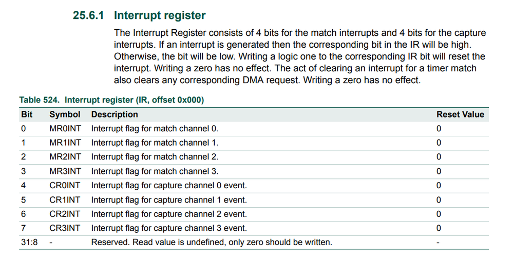

I am trying to initiate a Timer (Timer 0) interrupt on the rising edge of a pulse.
The timer is in the Timer mode so as to count the clocks between the rising edges.
Following is my initialization code

However, The callback function for the capture is never called.
The callback code looks like this
void ctimer_capture_callback(uint32_t arg_flags);
void ctimer_match_callback(uint32_t arg_flags);
 * Global Variables
ctimer_config_t g_ctimer_config;
ctimer_callback_t g_ctimer_callback[] = {NULL, NULL, NULL, NULL, NULL, ctimer_capture_callback, NULL, NULL};
uint32_t g_timer_val = 0;
uint8_t g_valid_lock = 0;
 * Function Definition
 if (CTIMER_GetStatusFlags(CTIMER0) & kCTIMER_Capture1InterruptEnable){ //Breakpoint here
The code never reaches the breakpoint ( if (CTIMER_GetStatusFlags(CTIMER0) & kCTIMER_Capture1InterruptEnable){ line) However the timer does get reset on capture so I believe the reset on capture functionality is working.
What am I doing wrong?

Ok so I fixed the "unable to program" issue and the original issue. Let run down the steps I took for each.
So for the "unable to program" issue. After a lot of googling I found https://community.nxp.com/thread/389040 and this https://community.nxp.com/thread/389112
The key line to look for was the:
Wire Ack Fault
in the console window.
So I did the ISP reset debug by holding down the ISP reset push button on my board, and then clicking the GUI Flash tool. Pressing run erased the chip successfully. Once done I released the ISP Reset button.
Once I regained control of the chip, I saw the sample for match interrupt and I realized that they left the first element blank so I recalculated the index of the capture 1 and rewrote this line to:
ctimer_callback_t g_ctimer_callback[] = {NULL, NULL, NULL, NULL, NULL, NULL, ctimer_capture_callback, NULL};
The callback is now at the 6 index position (when starting from 0). This fixed the problem for me.

I've been trying with different combinations to see which do work and which don't. So to answer the following question:
So Single Callback will always be at the "0" index position of the s_ctimerCallback.
That is correct if you state a single callback, you should put your callback in position 0. However if you use the single callback I would recommend to leave it like this to reduce errors ctimer_callback_t g_ctimer_callback[] = {ctimer_capture_callback};
or you can also state a Multiple Callback and leave it how you have it originally since the order you have it is correct as per the manual for capture channel 1.
So far I've not been able to replicate the behavior you are experincing.
Is it possible for you to attach your project? This way I can see excatly what you are seeing and I can better assist you.
Also note that LPCOpen and the SDK are completly different, so I wouldn't recommend to compare the two.

So far I've noticed that your RegisterCallback is stating  kCTIMER_SingleCallback. This is when you only have one callback for the timer, but in your array you have {NULL, NULL, NULL, NULL, NULL, ctimer_capture_callback, NULL, NULL}; This means that there are multiple callbacks available for your timer, regardless that the rest are set as NULL.
Can you please try to change your RegisterCallback to  kCTIMER_MultipleCallback and check if your breakpoint works.

I also notice that the bit in the IABR0 (NVIC->IABR[0]) bit 10 does not go high, however the CR1 (CTIMER0->CR[1]) seems to get loaded at the positive edge.
I checked by varying the pulse width of the input pulse on CT_INP3/P1_26, and the CR1 value changes correspondingly.
If I intend to use the single callback for capture, how would that work? Similar to LPCOpen?
But to check, I also placed a breakpoint at the start of CTIMER_GenericIRQHandler() as well. I think it too is not being invoked.
