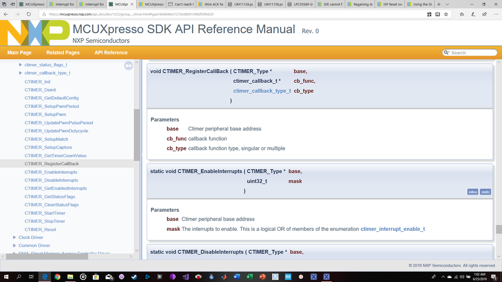

jeremyzhou
Hi Safiullah Hussaini,
Thanks for your reply.
It's the link (https://mcuxpresso.nxp.com/api_doc/dev/1222/index.html) of online documentation of SDK API reference manual which you can refer to.
