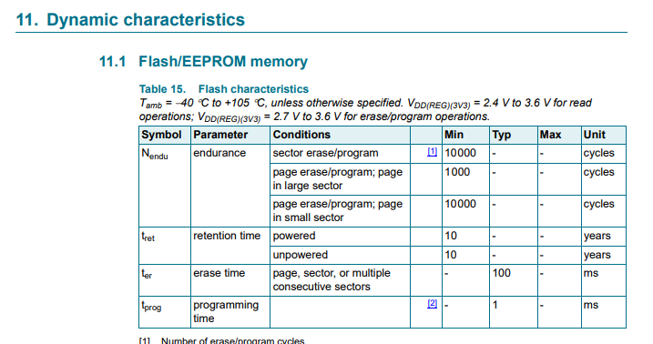

Could someone help tell me the erase cycle limit of internal Flash Bank A/B for LPC43xx?  I didn't see anything in the UM datasheet.  Thanks.

Thank you.
