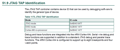

This is LPC space thus we can only answer LPC related PN. According to the related part UN.
This is Jtag identification ID for LPC435x:
This is for LPC176x/5x
For LPC11C24, UM doesn't have this data.
