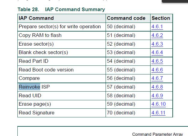

   You can use the IAP command: reinvoke ISP.
In the community, there has a post for your reference:
Entering ISP from user code
Wish it helps you!

I use the example lpcxpresso54608_driver_examples_flashiap and I try to boot to USB ISP - Reinvoke ISP, command 57.
So in the libray fsl_flashiap.c is not any function Reinvoke ISP, so I add my function to this library:
status_t Chip_IAP_ReinvokeISP( void )
uint32_t command[5], result[4];
command[0] = kIapCmd_FLASHIAP_ReinvokeISP; //57
command[1] = 8; //usb
iap_entry(command, result);
return translate_iap_status(result[0]);

From user manual, Reinvoke ISP input is:Command code: 57 (decimal), Param0: Pointer to ISP parameter structure. See Table 78.
You and I all write the wrong code, param0 is the pointer to ISP parameter structure, not the data directly.
Now, I modified the code like this:
