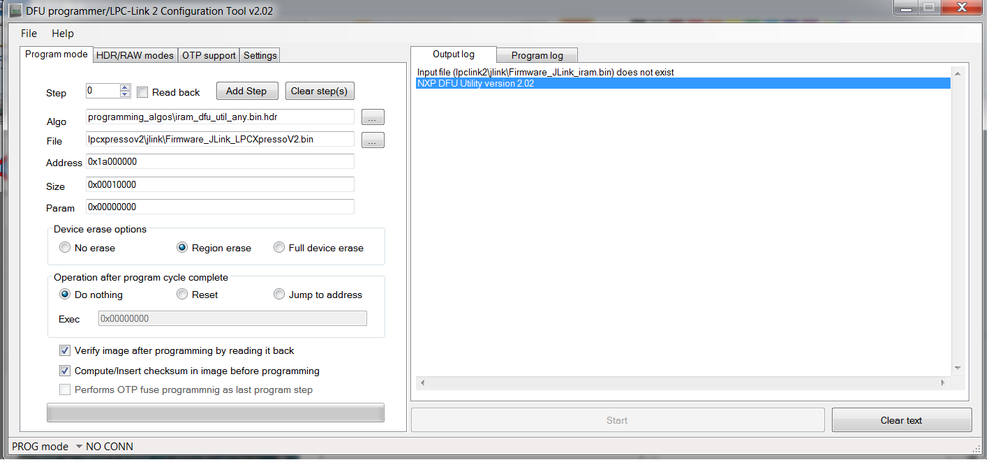

can me somebody  help me? I have a problem with DFU from LPC on the processor LPC54618:
The .bin file is normally copied to processor but:
1)DFU -  Operation after cycle: RESET  - NOT WORK
2)After restart the processor doesn't run.. - processor is dead
I have it too on LPC1837 and .bin files is copied without any problems . But restart doesnt work too...
It is originally program from LPC, but it doesn't work...
I need to do a update firmware by customer through internet (remote desktop)...
Thx

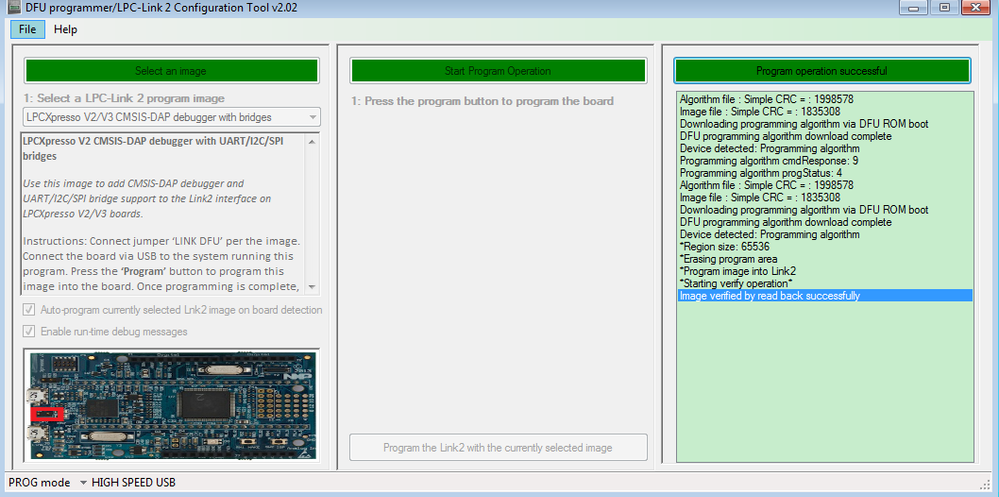

kerryzhou
Hi Jan,
   Thank you for your reply!

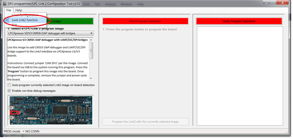

  Could you tell me how you enter the DFU mode like your picture?
  I just can get this picture:
I will do the test on my side at first.
Kerry

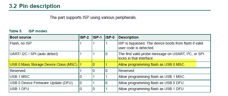

   Actually, I think you also can use the USB MSC function to download the .bin file to the chip flash.
I have test this function in our LPCXpresso LPC54618 board, it works OK.
If you have interest, you can try it.

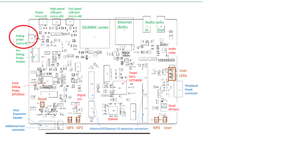

I don't have any problem with the connection. I insert a usb cable to micro B - debug probe and it works...

kerryzhou
Hi Jan,
    J8 is the debug port, if you use this port, you just can update the on chip LPC4322 DFU mode, not the LPC54618.
   Take care, the on chip LPC4322 is the LPC LINK2 debugger, normally, it updated the debugger firmware with JLINK or CMSIS DAP, not the LPC54618 flash.
   J2,J3 USB port is the LPC54618 chip USB port.
Kerry

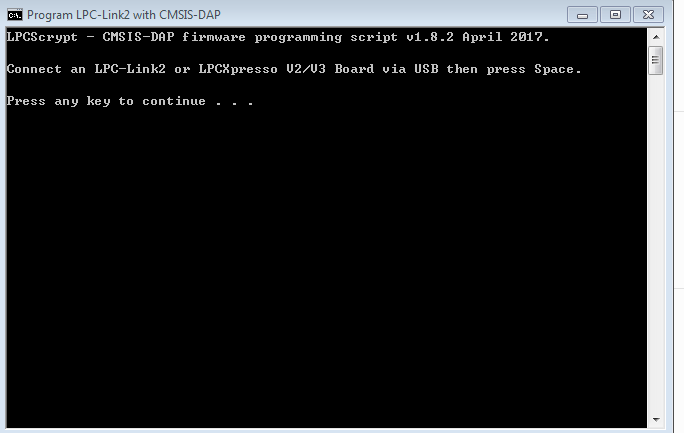

kerryzhou
Hi Jan,
   Missed you another question: I can try LPCScrypt and the program you can download to processor, but after restart doesn't work too
  Just as I have said, LPCScrypt just download the debugger firmware, not the LPC54618 bootloader.

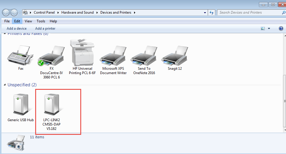

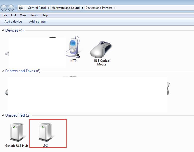

  Now take CMSIS DAP debug firmware as an example:
  1. Short JP5, connect J8
In devices and printers, you will find LPC,
2. Open program LPC-LINK2 with CMSIS-DAP in the LPCScrypt.
3. press any key, download the CMSIS DAP debugger firmware
Actually, you also can use DFU programmer to download the CMSIS DAP debugger:
4 remove JP5, power off and power on again, then your on board debugger is CMSIS DAP.
Kerry

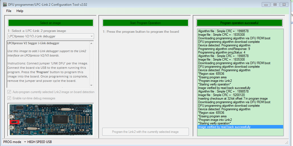

phateee
I tried it and when I copy hex into procesor, verify operation is failed. And after restart processor the program is not running...
14,733件の閲覧回数
phateee
14,733件の閲覧回数
kerryzhou
Hi Jan,
  Deselect verify, just download, then check your application code, you will find your app already work.
Kerry
14,733件の閲覧回数
phateee
Yes, when I deselect verify after programming, it works good...but I don't then, if the code is without errors...:)
thank you

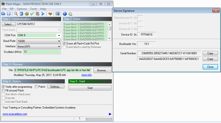

kerryzhou
Hi Jan,
    Yes, you should better find a TTL-USB tool, and connect it to P4.
   This is my test result with flash Magic:
1. Modify the SDK2.2 flashiap code, Chip_IAP_ReinvokeISP, which I already post before.
Main code:
int main(void)
    uint32_t i, status;
    unsigned int t1=0,t2=0;
    /* Board pin, clock, debug console init */
    /* attach 12 MHz clock to FLEXCOMM0 (debug console) */
    CLOCK_AttachClk(BOARD_DEBUG_UART_CLK_ATTACH);
    BOARD_InitPins_Core0();
    BOARD_BootClockFROHF48M();
    BOARD_InitDebugConsole();
    Chip_IAP_ReinvokeISP();
    while (1)
2. Then open the flash magic
  You can find the UART ISP works.
  Now, you can generate the app.hex file, and put it in the step 3, I use the sdk gpio code as the app.
3. Download the code
4. After download code, press Go,
Then you will find your app works.
Kerry
