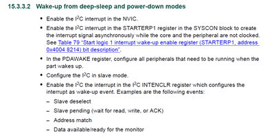

I am using LPC802 and trying to use it as an i2c slave device.
I had already build a project with out power saving and work good.
But when i trying to let it go into power-down mode, it works strange.
Is there any sample for me to study?
attach file is the code i'm using.

ZhangJennie
Hi frank-lin-Sunon
I2C slave can wake up Power Down mode. We need to make sure I2C interrupt is enabled.
Regarding to demo code. Under MCUXpresso SDK, there is  power_mode_switch_lpc. This demo doesn't include exact I2C wakeup. the demo wakeup sources are :
1. PB3,wakeup key
2. Wkt timer
3. PB2, reset key
You can refer them are reference.

ZhangJennie
Hi frank-lin-Sunon
Please make sure you follow the right process before enter power down mode. especially configure FRO as main clock
besides, please also make sure if you well configure I2C as wake up
when checking, use logic analyzer to measure I2C clock and data, if there is correct signal there.
