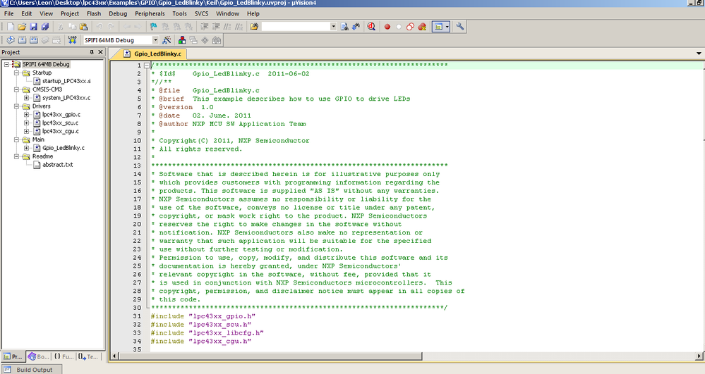

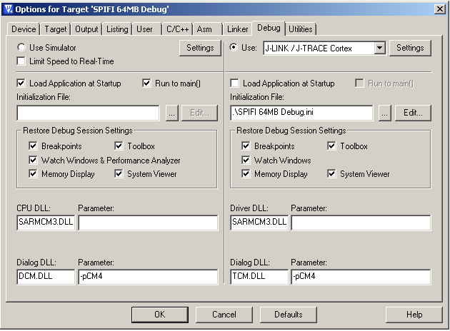

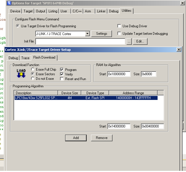

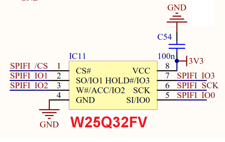

I've used W25Q32FV as Flash and I've programed the example of NXP LPC43xx-GPIO, but it has this problem. Does somebody know where my problem is?

Erase Done.
Programming Done.
Contents mismatch at: 14000000H  (Flash=FFH  Required=58H) !
Contents mismatch at: 14000001H  (Flash=FFH  Required=08H) !

Error: Flash Download failed  -  "Cortex-M4"1.png2.png3.png4.png5.png

Can I use this IC for flash: W25Q16BV.
How can I use that?

Hello Leon,
You need to use SPIFI library. You can find more information in the following link:
LPC SPIFI Peripheral|NXP
For schematic reference, you can check the LPC4330 Xplorer board:
https://www.nxp.com/downloads/en/design-support/LPC4330_Xplorer_schematic_OM13027.pdf
Regarding the QSPI devices, multiple QSPI devices from various vendors can be used with the SPIFI interface and the SPIFI API available on nxp.com. The devices listed in the following table are tested to work as boot devices for the LPC43xx and with the SPIFI API.
Remark: All QSPI devices have been tested at an operating voltage of 3.3 V
