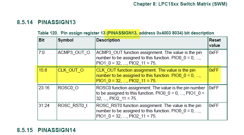

    You can configure these register to output the main clock and test it at first:
Just make sure the main clock is really 72Mhz .

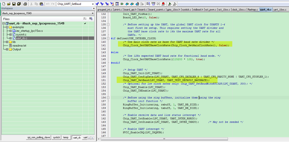

If it is really 72Mhz, then you can refer to the LPCopen uart_rb project, which can be downloaded from this link:
 LPCOpen Software for LPC15XX|NXP

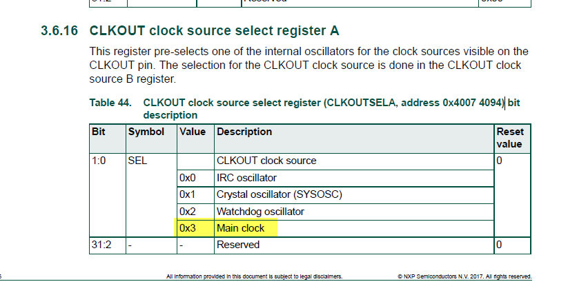

     What the clockout code you have wrote? Maybe your clkout code also have problems.
     Please check following code, my system clock is 72Mhz, and I use PIO1_0 pin to output the system clock.
          Chip_SWM_Init();
     Chip_GPIO_Init(LPC_GPIO);
     /* Setup pin as CLKOUT */
     Chip_SWM_MovablePortPinAssign(SWM_CLK_OUT_O, 1, 0);
     /* Configure as a digital pin with no pullups/pulldowns */
     Chip_IOCON_PinMuxSet(LPC_IOCON, 1, 0, (IOCON_MODE_INACT | IOCON_DIGMODE_EN));
        LPC_SYSCTL->CLKOUTSEL[0] = 3;
     LPC_SYSCTL->CLKOUTSEL[1] = 0;
        LPC_SYSCTL->CLKOUTDIV = 1;‍‍‍‍‍‍‍‍‍‍‍‍‍‍‍‍‍‍‍‍‍‍

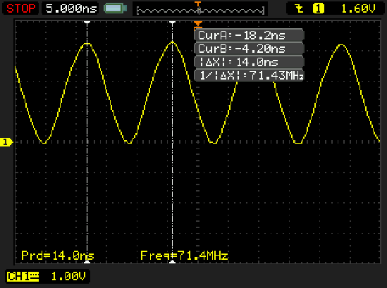

Then this is the test result:
You can find it is about 72Mhz.
So, please double check your clock out code again, I test it based on the lpcopen code, actually, the lpcopen code also have a periph project named as clkout, you also can refer to it.

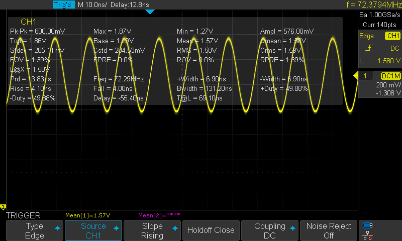

athmesh_n
Hi kerryzhou‌,
Thank you for the code snippet.
I got the following output with frequency 72.29MHz.
4,312 Views
kerryzhou
Hi ATHMESH NANDAKUMARK,
    That's good, it means your main clock works OK with 72Mhz, now, please refer to the lpcopen uart_rb code to configure your UART, then test it again.
    If you still have problems, please let me know, and tell me what the UART module and the pins you want to use.
