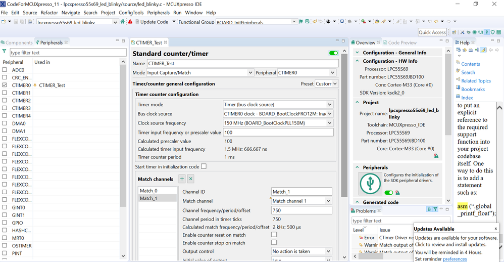

Just downloaded MCUXpresso Config Tools.
Using processor LPC5528.
When I set up a CTIMER, I see a tab to add match channels, but no way to add capture channels?
What am I missing?
Thanks!
Best Regards, Dave

Hi, Dave,
You are right, I have tested the CTimer function of the peripheral configuration tools, the capture feature of Ctimer module is not supported by the version of peripheral configuration tools.

xiangjunrong‌ - Are you reporting this as a bug in Config Tool??

Hi, Dave,
Thank you, I will report the issue to software team so that the capture feature can be supported.

Thanks xiangjun.rong‌, I understand this is confirmed as a bug in Config Tool.
Can you tell us when this will be fixed?
