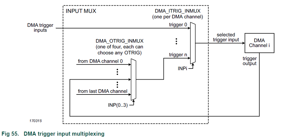

  1. The term 'trigger' is used completely ambiguously for many purposes, where it is normally meant to be an input and/or event. NXP documents use trigger sometimes as a DMA input and sometimes an output. DMA inputs that start the DMA are more usually called requests. I've never seen DMA completion events called a 'trigger' by anyone except NXP. At a minimum 'trigger' should always be disambiguated: use DMA trigger input or DMA complete output signal.

  • The "trigger output" is a signal of the channel that can be used as input trigger for another DMA channel. The DMA requests are connected to a peripheral, these requests go through a multiplexer where they are associated with a trigger. This image may help to understand this:
