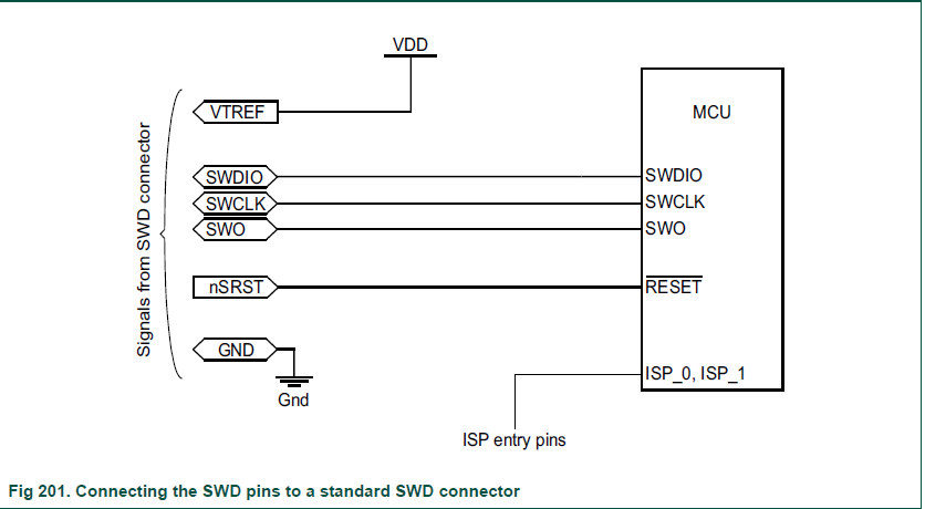

I do not understand the wording in chapter 47 on how to select JTAG port for MCU debug at power up. How do I select JTAG port from hardware standpoint ? I do not understand how the boundary scan work to select SWD or JTAG for debug port. Please advise. thank you.

LPC54 parts are based on Cortex-M4 which are SWD only for debug - there is no JTAG debug.

Thank you for shedding some light on this; This is very confusing because Chapter 47 makes it sound otherwise (table 1118).
How do ISP_0 and ISP_1 come into play in SWD ? . i.e. how do they affect SWD functionality if SWD is the only option for LPC54xxx.See below:

Table 1118 is describing Boundary Scan NOT Debug. The table is titled
"Table 1118. JTAG boundary scan pin description"

belmontbob59
I disagree, ISP0 and ISP1 pin do affect SWD. As described in 47.6.2:
I use KEIL with ULINK2 on LPCXpresso54S018M via P1 (SWD). If I hold either SW4 (ISP0) or SW3 (ISP1) then power up or reset while keeping the switch pressed, then I can not access the MCU via the debugger. If I do the same experiment with SW2 (ISP2) then I can access the MCU via the debugger.

jeremyzhou
Hi Bob,
Thanks for your reply.
The voltage state of ISP pins will affect the boot sequence of LPC MCU, and they usually force the MCU to enter ISP mode. Overall, they're independent with the SWD port.
