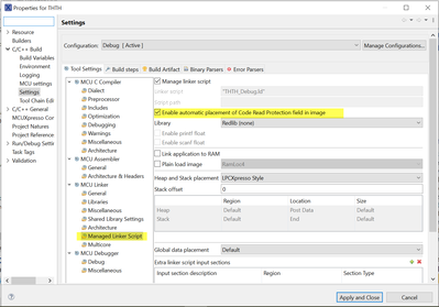

There is CRP (Code Read Protection) feature available for LPC804 MCU. This CRP is located at address 0x0000 02FC and there NO_ISP / CRP1 / CRP2 / CRP3 / CRP4 these different security levels.
My question is, how to program the security level into this location? by ISP mode only?

You can config the CRP in your project. For example MCUXpresso IDE, enable CRP as below:
then configure CRP value:
About CRP, recommend:
https://www.nxp.com.cn/docs/en/application-note/AN11581.zip
https://www.nxp.com.cn/docs/en/application-note/AN10968.pdf

Thank you very much, Alice! With your kind help, LPC804 CRP got success in my product now!
