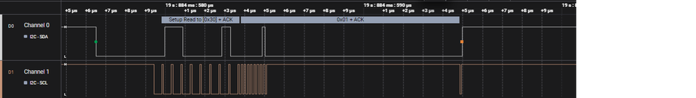

Hi there,
I'm trying to program I3C IBI without a stop condition after the mandatory byte data, and connecting a restart condition to read data afterwards. How could I do?
Below is the IBI waveform that I did with MDB.

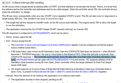

Hi @sam_wu_7911
According to the LPC553x Reference Manual.
The controller automatically stops IBI data after nine total bytes (including Mandatory Data
byte).
May I ask what your specific application is?

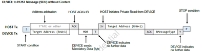

Hi @Harry_Zhang
This application is a bridge between the target and the PC/laptop with HID-I3C Protocol.
According to the document of HID-I3C Protocol, after the MDB shall be a restart condition directly. Please see the figure below.
I wonder if LPC55S36 cannot match this requirement, is there another NXP MCU that can match?

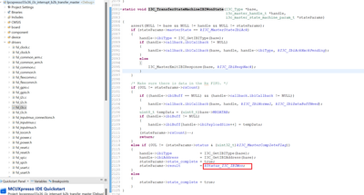

The lpc55s36 can match this requirement,
You just need to add
handle->state = (uint8_t)kWaitRepeatedStartCompleteState;
after
stateParams->result = kStatus_I3C_IBIWon;
