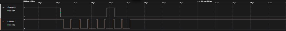

Hi there,
I'm trying to implement the flow of hotjoin with the I3C bus. However, when the target triggers the hot join address (0x02), the SCL stop at the 8th clock tick. No clock for R/W and ACK, do you have any idea?

Hi @sam_wu_7911
May i ask is your target also lpc55s36 board?
Harry
1,107件の閲覧回数
sam_wu_7911
Hi @Harry_Zhang
Yes, I did try the target of the LPC55S36 board.
Also, I tried another sensor IC with the same situation.
Could you please provide me with a solution for triggering the last two clock ticks? I'll appreciate it.

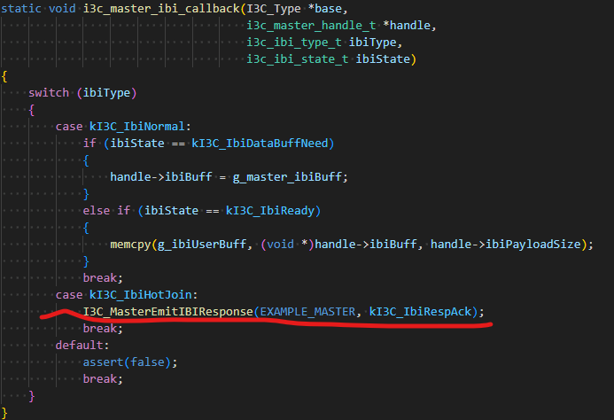

When you enter Hot join,
You can try to send response ACK.
I3C_MasterEmitIBIResponse(EXAMPLE_MASTER, kI3C_IbiRespAck);
And then  dynamically assigning addresses.
Harry
1,051件の閲覧回数
sam_wu_7911
Hi @Harry_Zhang
Do you mean when the Controller received the Hot Join Interrupt, sending a response ACK?
Is it like the code below?
BRs,
Sam
1,029件の閲覧回数
Harry_Zhang
Hi @sam_wu_7911
Yes, you are right. and then dynamically assigning addresses.  you can try.
Harry

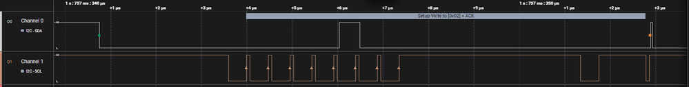

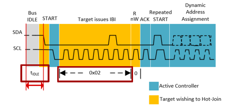

sam_wu_7911
Hi @Harry_Zhang
After applying your solution, the last two clocks appear. However, after the ack is the stop condition, and that doesn't match the I3C spec.
Following the spec, there shall be a repeated START condition rather than a STOP. Do you have further ideas?
516件の閲覧回数
Harry_Zhang
Hi @sam_wu_7911
In i3c spec, after the ack is the stop condition or repeated start condition.
This is my code.
You can try.
Harry
