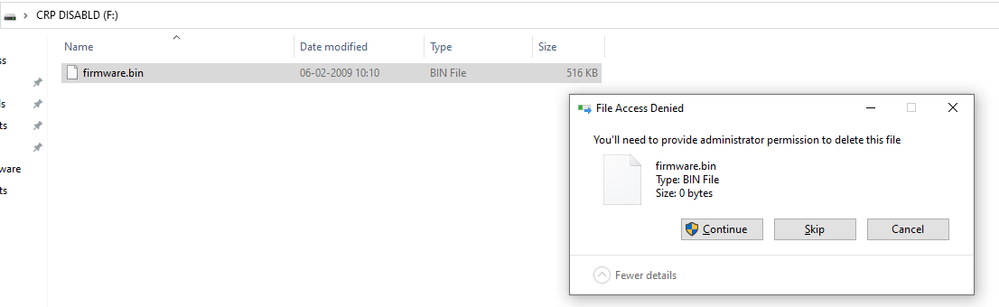

jbhoi
Hi Bernhard Fink,
I tried the mass storage method, device opened in mass storage mode, i can see firmware.bin inside it. But when i delete it and not give permission to delete it..see below error.
Then tried to delete it by opening Command prompt with Administrator rights, still same issue.
