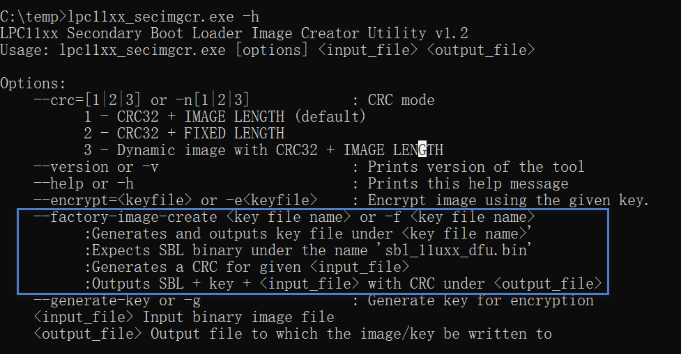

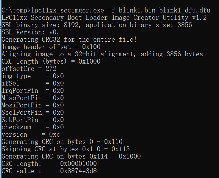

ZhangJennie
Did you try -h option?
What I tested from my side:
The generated blink1_dfu.dfu includes both SBL and application file.
Jun Zhang
5,264 Views
d_m_
Thanks for your answer.
I did look at the “help” of the “lpc11xx_secimgcr.exe”, and as mentioned in the question of my initial post, I tried the “--factory-image-create” (i.e. “-f”) option. I thought that the “<key file name>” argument was mandatory. Personally, I would have use brackets in the help to denote this argument: “[key file name]”.
Unfortunately, this solution with the “-f” argument does not work on my side for two reasons:
  1. The resulting factory image does not work when programmed to the development board (using base address 0). However, with the srec_cat command and the same initial files it works.
  2. The help section of “lpc11xx_secimgcr.exe” mention that the SBL is expected to be a file named “sbl_11uxx_dfu.bin”, but it does not seem to take this file when present (Note: in the “image-creator-tool” folder, the SBL is “sbl_dfu_lpc11u60.bin” and with both names “sbl_dfu_lpc11u60.bin” and “sbl_11uxx_dfu.bin” this does not work). By looking at the binary, the first part of the generated image does not correspond to the provided SBL. Take a look at the resulting factory image binary and compare it to the SBL binary.
I may be doing something wrong, but it seems more that the tool does not provide the expected output.

5,264 Views
ZhangJennie
Hi David,
I contacted the author. you are right the lpc11xx_secimgcr.exe may has problem.
Your method of using srec_cat.exe to combine files is recommended.
Best Regards
Jun Zhang
