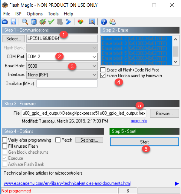

Regarding 1, please make sure you are doing the following:
-Connect your USB to Serial converter to UART0, this is connected to FTDI header at P3.
-Make sure you power the board through J6 (leave J5 disconnected).
-Press SW2 (ISP0) during reset to enter ISP USART mode.
Open Flash Magic and follow the next snippet:
Regarding 2 and 3:
To flash your LPCXpresso board using Flash Magic you will need a .hex file (as shown in step 5 of the snippet above). Please check the following tutorial to create S-Record, binary and hex files in MCUXpresso (same process can be followed in LPCXpresso).
MCUXpresso IDE: S-Record, Intel Hex and Binary Files
I hope this helps you.
Felipe

Flashmagic tool seems can only download image through SUART interface, on my OM40005 board, I have tried the flashmagic tool to 51U68 without success, but success with onboard LINK2 MCU, so my question are:
1. Follow UM11121 LPCXpresso51U68 user guide, I have tried every jumper setting and procedures, only LINK2 MCU ISP mode can be identify via J6's VCOM, but always fail to LPC51U68 FTDI header ( i make a ftdi 232 cable, work for run power manager demo), so what is the correct jump setting/circuit rework for OM40005 board to make LPC51U68 ISP working with flashmagic.
2. Even flashmagic can work, I still don't know how to make the neccessary rom file (HEX format) using LPCXpresso IDE, please provide related guide.
3. We will not have UART interface on production board, so UART ISP can work, the simplest way is USB MSC ISP mode. from the UM11121 guide, I just need to put firmware.bin in it USB MSC, but how to make the firmware.bin using LPCXpresso IDE?please provide related guide.
Andy

Hi Andy,
Regarding 2 and 3:
Felipe
