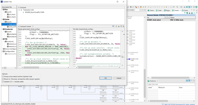

Modify the example to PIO0_13 and PIO0_14 which is FLEXCOMM1.
When I configured Pin. And configure associate module configuration.
The I2C result as below, The SCL clock is 800KHz,but the SDA data is right.
Is I2C Fast Mode Plus need configured something ?

I found the cause what the I2C can not output 1MHz.
I tried configure the flexcom1 through MCUXpresso Config tool.
Configured clock to flexcom1, it call API CLOCK_SetClkDiv with kCLOCK_DivFlexFrg1.
It's different with SDK example. It is necessary to configure  CLOCK_SetClkDiv ?
Or, it is necessary configuration to Fast mode plus?

I was checking your code and I realized that you missed to enable the FRG1 (Free Running Generator) that is needed to have the clock of 12MHz activated for FlexComm1 (selecting the option of FRO 12MHz Clock in the column value), so the answer is Yes, it is necessary to configure CLOCK_SetClkDiv for having Fast Mode Plus.
You can check the changes that can be implemented right here:
Regarding your question about if fast mode plus is only possible on slave mode, the answer is no, you can set this bus speed for both modes, as master or as slave. Only for High-speed mode (3.4Mbit/s) is possible on slave mode.
