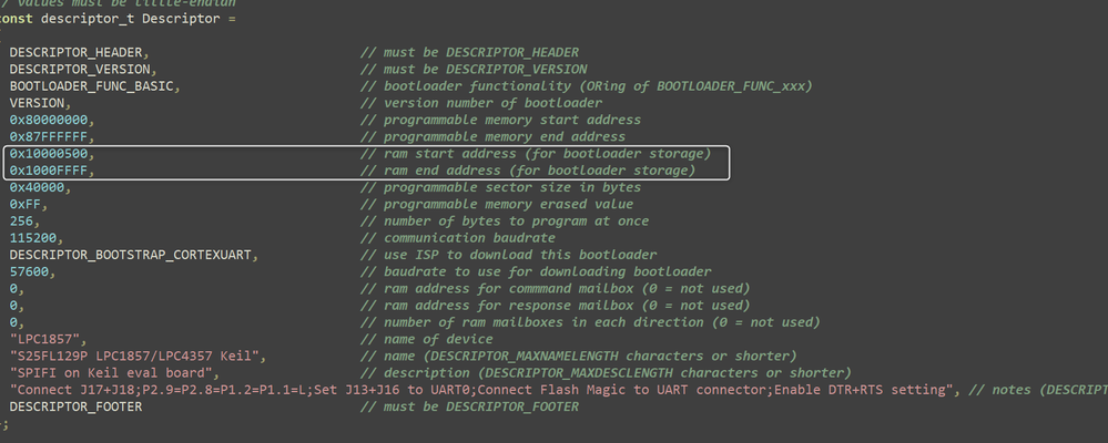

1. To modify the boot loader, open the example given in C:\Program Files (x86)\Flash Magic\Bootloaders\External Memory\S25FL129P\LPC1857-Keil and then modify FlashPrg.c descriptor to specific values needed(mostly Sector Size, bytes to program at once).  BaudRate = 57600 at both places recommended as we observed data loss for greater baudrates. modifying description is optional.
2. Change the Output options as you wish and you get a bootloader hex file to be placed on the location C:\Program Files (x86)\Flash Magic\Bootloaders.
3. Now the important step to generate application hex file with adrress mapping to 0x8000 0000 to 0x87FF FFFF but NOT 0x1400 0000 to 0x17FF FFFF. Its because of the above descriptor and description from the Manual

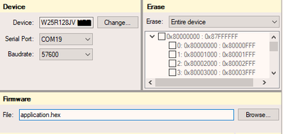

4. Once both hex files are ready, Open Flash Magic, Change the device to External Memory-> UART. You should see your bootloader hex file there and choose it.  Choose the application hex file too.
5. Click start and first Erasing happens and then programming. Because the LPC18xx series support XIP, the program should start itself on reset.

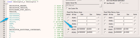

We have taken the sample code given by Flash Magic External bootloader section code(attached). The flashprg.c for given S25L129P example is as follows. We have just modified the programmable sector size for
To answer your question, No we are not using the specified RAM space. you can see that being highlighted in the screenshot.
Kindly look into the attached code and guide accordingly.
