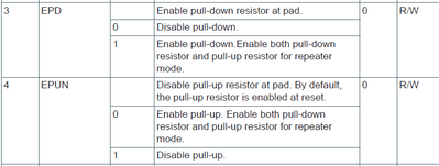

We are currently struggling to disable the internal pull-up resistor on a SCT input pin.
We are using the OM13084 board and the pin we are using is:
Header: J1.19
Pin: P2_6
Function: T3_CAP3
Where can we set the mode of this pin?
According to UM10503 page 258, the reset state of this pin can either be Neutral or with a pull-up.

I found the following information, unfortunately, during the reset state the pull-up can not be disabled, but at the moment the MCU is stable you can disable it with the next register.

Thank you, we managed to disable the pull-up resistor.
