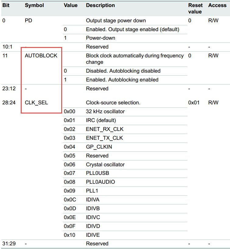

  •      I have to get ADCHS value from LINE SCANNER that is working 8MHz clock. So I have to create external clock for LINE_SCANNER
  •     This Clock will be connected to ADCHS external triggers for triggering.
    • I saw Manual (UM10503-USER-Manual) section 48.7.6 and Section 18.4.25
Please let me your solution to create clock for LPC4370 in LPC-link2 board.
  1.      Am I right analysis for connecting and getting ADCHS with LINE SCANNER ?
  2.       I am doing to create Clock which is 8MHz to out CLKOUT (P1_19 port)
    1.      How can I set up to make 8MHz clock that will be route P1_19 for CLKOUT ?

To generate the clock via the CLKOUT pin ( you choose the P1_19), you need to active clock block and select clock source simultaneously via the BSE_OUT_CLK register at first. Next to configure the P1_19 to output clock via the Pin configuration register as the Table 192 illustrates.
In the previous reply, I pointed out that hardware triggers is not necessary to connect some additional PWM to trigger the ADCHS,
The internal hardware trigger will connect the ADCHS automatically via configuring the GIMA module.
Hope this is clear.

jeremyzhou
Hi LEE Young Jae,
Thanks for your reply. I think I missed one information before.
Hope this is clear.
