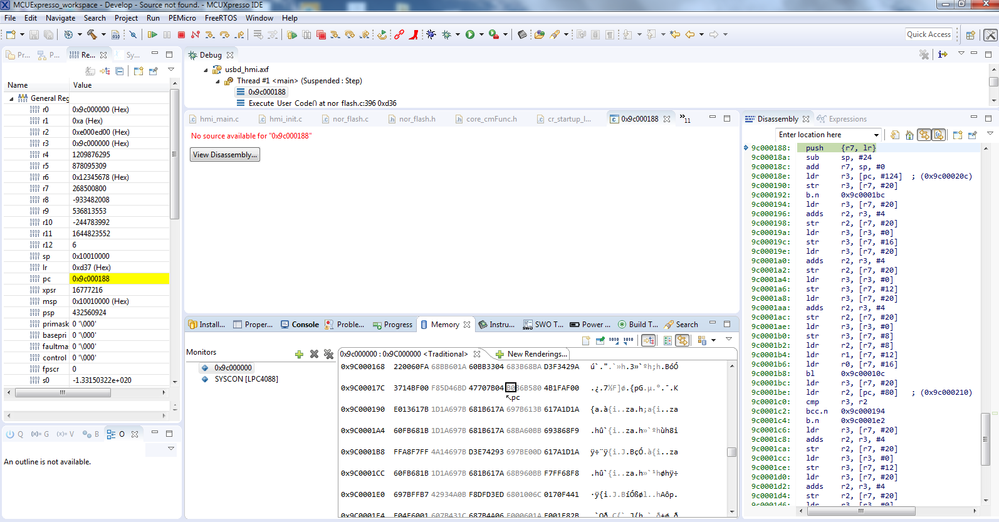

priyankb
Hi jeremyzhou‌,
As you suggested, I have made some changes in my code & configuration but unable to successfully jump to user application.
During debug I found that SP, PC locations are correct but in disassembly window continuously get "failed to execute mi command data-disassemble" error.jump_debug.pngjump1.png
I don't understand the problem. Could you point out the changes need to execute jump from internal flash to external flash.
Thank you.
Priyank.
19,958件の閲覧回数
converse
Senior Contributor V
You can see that in your 2nd screenshot, the registers are all garbage - the PC is 0x6a9f3574, which is why you get the disassembly errors.
Have you (assembly) single stepped to see at which point it goes wrong?
What is the code that is setting up the stack and PC?
In your 1st screenshot, the PC is already at 0x9c000188, so it looks like it has jumped to your code, with the SP set to 0x10010000, so what is on the stack at this point?
My guesses are that
a. your (external flash) code is returning, but the stack is garbage
b. an interrupt has fired and either the vector table is not setup correctly, or the MSP/PSP is wrong

priyankb
The 2nd screenshot is the one which occur when I try to jump to location 0x9C000189 & the PC jumps to the location stored in that address(0x9c000189) which does not happen when jump to 0x9c000188.
In normal condition the bootloader application continuously resets & user app never gets executed.
Stack points to RAM location 0x10010000 which is same as bootloader.
This is my boot jump code(one of many i tried).
void boot_jump(uint32_t addr)
     __asm volatile("LDR R1, [R0]");
     __asm volatile("LDR SP, [R0]");
     __asm volatile("LDR PC, [R0, #4]\n");
     delayMs(5);
void Execute_User_Code(void)
     Chip_SetupIrcClocking();
     __disable_irq();
     //Clear interrupts
     NVIC->ICPR[0] = 0xFFFFFFFF;
     NVIC->ICPR[1] = 0x0000001F;
     SCB->VTOR =  APP_ADDR & 0xFFFFFF80;
     boot_jump(APP_ADDR);
Now my main concern is about vector table mapping. It is seen in .map file that it is present in external flash & I need to copy it to RAM. But in ResetISR() I cannot access external flash not until SystemInit() where EMC initializes.
Any suggestions to solve this problem would be very helpful.
Thank you.
Priyank.

jeremyzhou
Hi Priyank Bhatt,
Thanks for your reply.
The application code is independent with bootloader, definitely,of course, it's impossible to debug when debugging the bootloader code.
About application code, you should be careful with clock initialization, as EMC maybe inactive when clock configuration changes, please beware of it.
Considering the performance and implementation difficulty, in my opinion, on-chip is used to store code even only has the partial code, versus the external flash is used to store the data, it's a suggestion and maybe you can give a try.

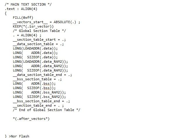

priyankb
Hi jeremyzhou‌,
I understand what you are saying. But my code is going to be large and won't fit in internal flash that is why using external flash.
In bootloader:-
1. changed SP, PC   (values are correct in debug)
2. calling Chip_SetupIrcClocking() for IRC clock.
3. disabling all interrupts & clearing remaining request
4. calling __set_CONTROL(0);       (I don't know if relevant)
This is the user app linker & map file & it looks correct
19,958件の閲覧回数
