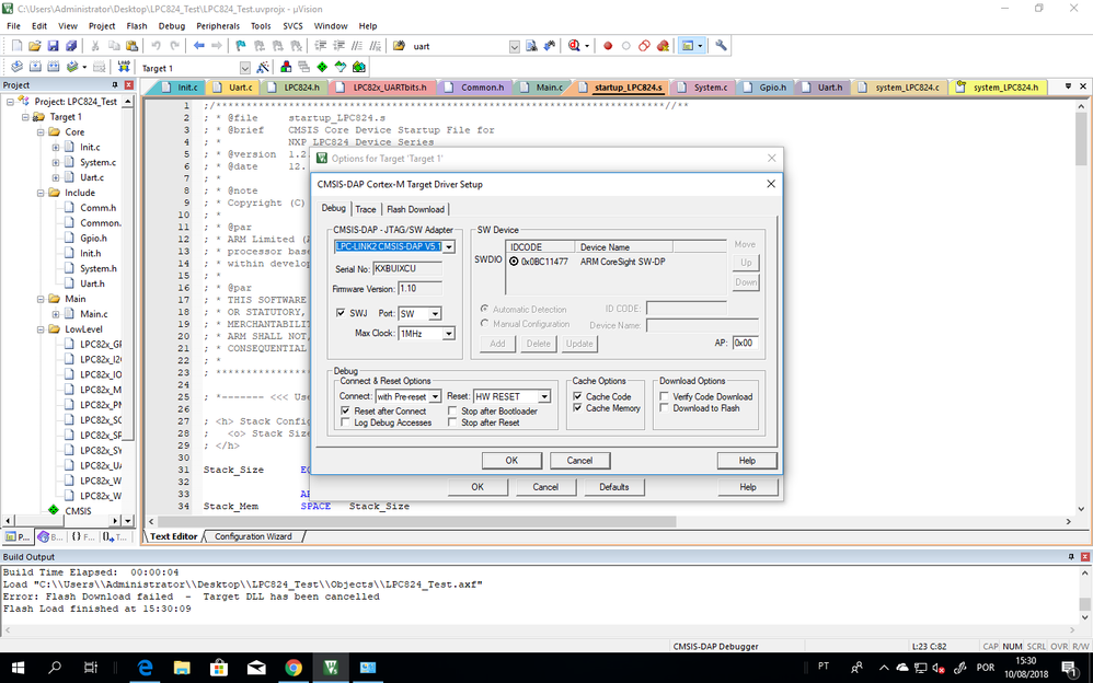

After solving a series of errors communicating with the LPC824M201JHI33 in Keil´s uVision5.25 IDE the error invalid Rom table started occuring, even though the board responds to code sent before the first occurrence of said error and none of the solutions we found worked.
Everytime we try to download to flash the error shows up, we´re using the CMSIS-DAP debugger more specifically LPC-LINK2 CMSIS-DAP V5.182 and we´ve tried changing the debug settings to no avail.
please help.

rodriguesnuno97
Unfortunately I am not able to explain to you how I got to this error but I copied the project folder to a flash drive to create a backup and then when I tried to load to flash said backup, the error showed up.
My debugger settings are Port:SW ; Max Clock:1Mhz ; Connect:with Pre-reset ; Reset:HW Reset
with reset after connect, cache code, cache memory ticked.

Hi  Nuno Rodrigues,
I was wondering if you can introduce the steps to replicate the error and share the screenshot of this error.
It helps me to figure it out.
