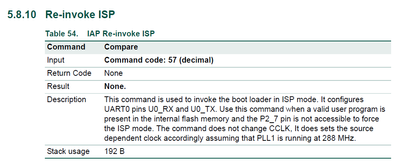

Is it possible that LPC1830 reset to ISP mode from application?

Hi Ken,
You can use the reinvoke ISP IAP command.
Felipe
