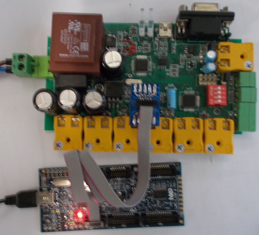

See  my  lpcLink2

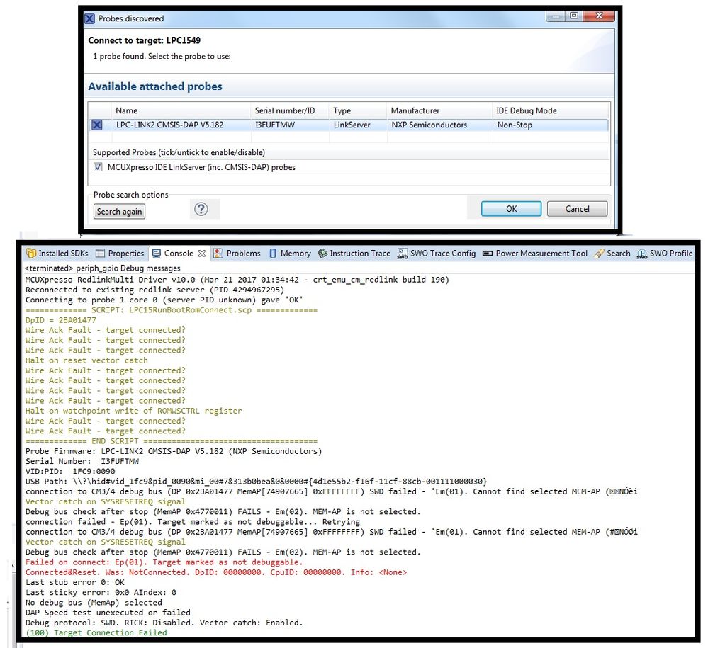

olivierpohu

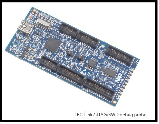

Hi Kerry , I have buy the LPC Link2.. The reponse is not   yet correct .
That say me "Cannot find selected MEM-AP"
Have you A idee of this  réponse  ?
Thanks for all kerry...
9,088 Views
kerryzhou
Hi Olivier,
   Sorry for my later reply because of China's National Day and Mid-Autumn Festival.
    It seem your hardware have problem.
   1. Check the SWD interface, whether it is correct with the LPC LINK2,
  This picture is the LPC LINK2 SWD interface:
Check the connection with your board.
Normally, the SWD interface need this pins:
pin1:3.3V.
pin2:SWD_DIO, this pin you need to add external 10K pullup resistor in your board.
pin4. SWD_CLK, take care, you don't need to add external pull up, even you add, you just need to add the pull down.
pin10: reset pin
pin3,5,9: GND, connect to your board GND.

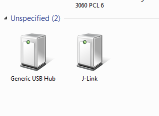

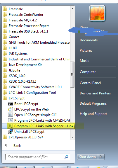

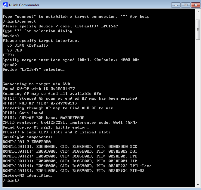

2. Use the JLINK firmware to check the core
  If your point 1 is really correct. Then check this part.
1) download and install the JLINK driver
SEGGER - The Embedded Experts - Downloads
 2) Change your LPC-LINK2 to JLINK firmware
Download and install the LPCScrypt
LPCScrypt v1.8.2|NXP
power off the LPC LINK2, disconnect JP1, power on the board again(J5 USB port), you will find you board is the LPC device, it is the DFU mode.
Open the jlink in LPCScrypt:
Press any key, wait the jlink firmware download finished:
Then power off the board, short jp1, power on the board again, in control panel, you will find you board is JLINK.
Open JLINK command in the JLINK driver install path:
Can you find Cortex M3 core?
Please check this at first, if you can't find it, you need to check your LPC board, your hardware have problem.
Kerry

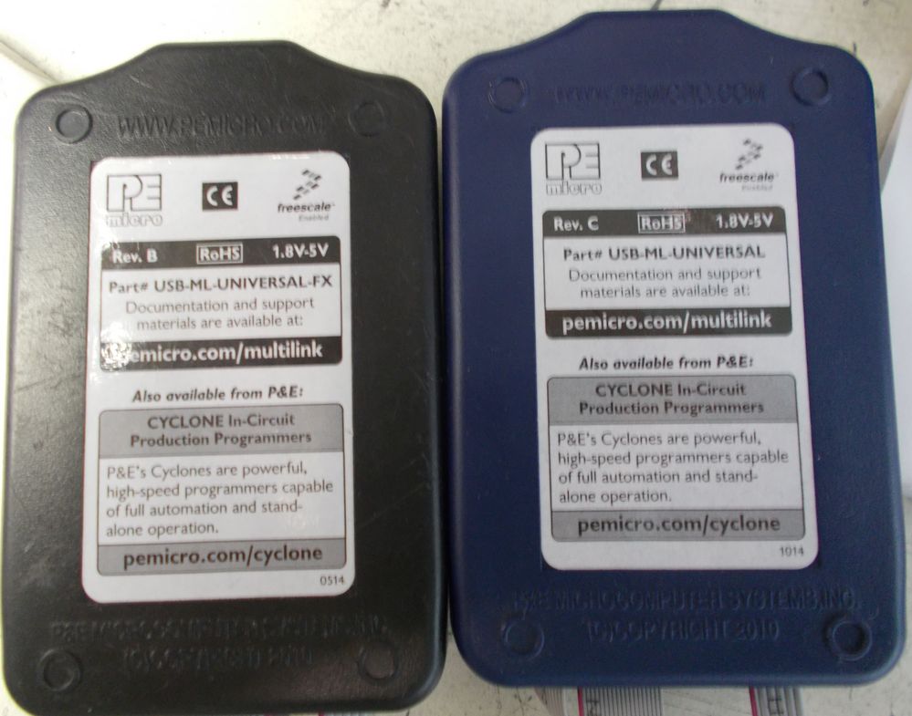

olivierpohu
Hi Kerry...
Ok  I think, i must buy CMSIS DAP  debugger like you.
My debugger function correctly with freescale processeur ( 51JM128)
PE micro have say me that Usb MultilinkFX rev B or USB Multilink RevC
function with lpc chips. But i think that no.
I think my program is correct and my hardware is correct too..
For the configuration of Mcuxpresso i have all try ...
Thanks for all
Olivier.

kerryzhou
Hi Olivier,
   I am really not very sure about the Multilink for LPC, because I don't have MultilinkFX rev B or USB Multilink RevC on my side. That's why I let you try IAR or MDK project, just make sure it is not the IDE problem.
   Normally, for LPC, we use the official LPC LINK2.
kerry

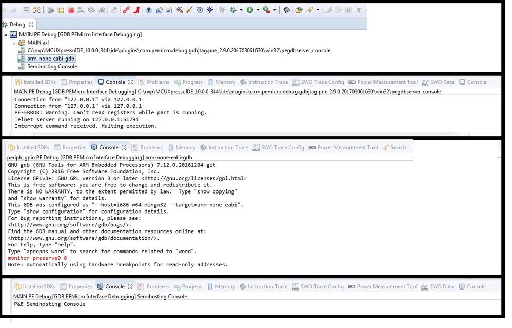

olivierpohu

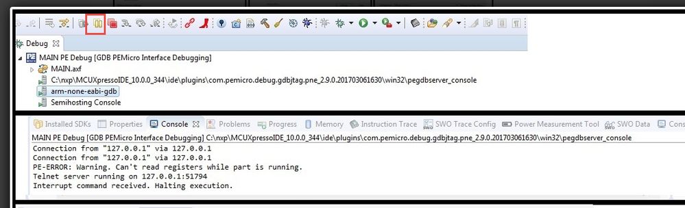

Hi Kerry . In fact with Pemicro Probe,
you must charge the arm environnement with the PE firware UPdater and charge Arm Processeur.
 Effectively i can not entry in main..... With the semi hosting that made the same thing...
That say : "PE-ERROR" Warning Can't read register while part is running
A+
9,088 Views
kerryzhou
Hi Olivier,
   My Multilink is mainly used for kinetis chip, it has no license for LPC chip.
    Now, can you also try it in the IAR or MDK IDE, whether your PE multilink can work or not?
   Just to identify the problem from IDE or debugger tool.
   If your IAR or MDK also have the debug problem, I think you need to contact with P&E to check the problem.
   I have test the JLINK and CMSIS DAP to debug the LPC chip in the MCUXpresso, it has no problem. If the IAR and MDK don't have the debug problem with your Multilink, please also let me know, I will help you to check it with our MCUXpresso IDE colleague.
Kerry

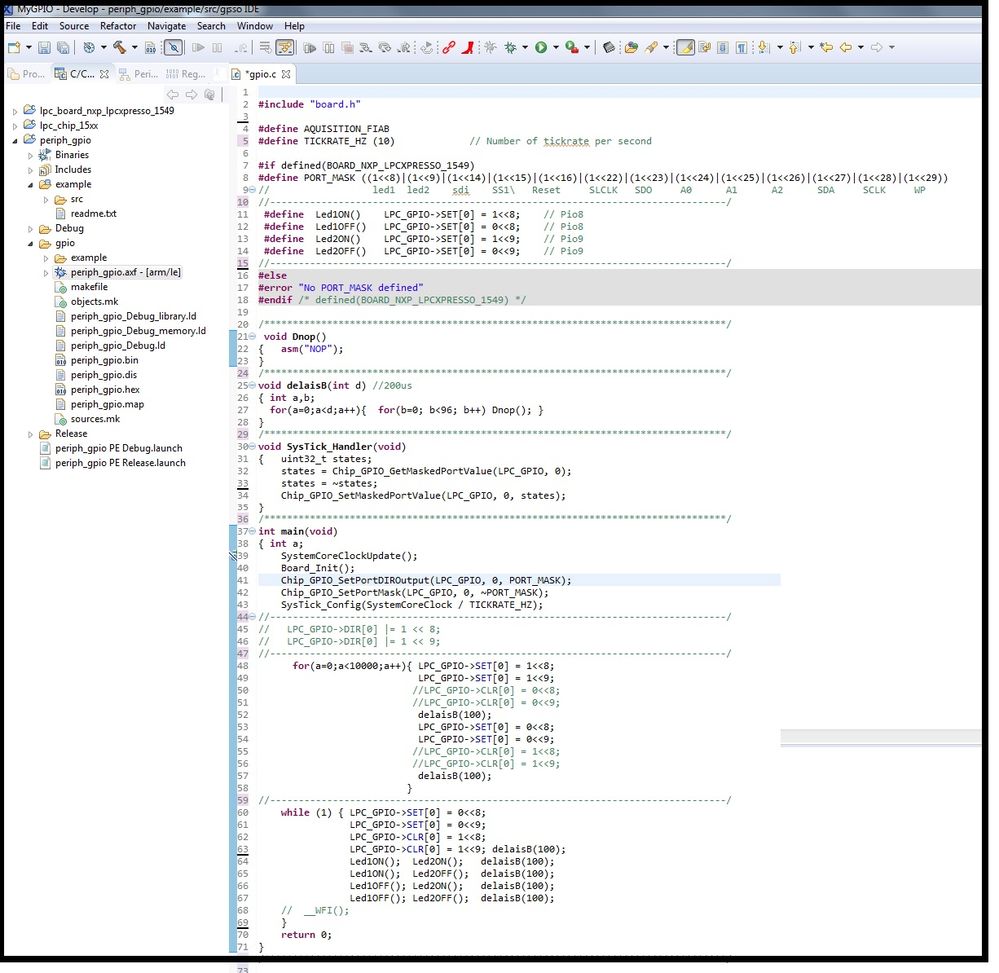

olivierpohu
Hi Kerry,
I have doing  wath you Say  me... Stop the pause buttons  and comment the line WFI() ;  I have ask to PEmicro if
the multilink universal rev B and C can program the LPC1549 with the insert program "arm" , they say me "OK"...
but That don' t function ...I joint to You my program who is very simple....Prog.jpg
 the réponse of the buttons pause is
but my micro dont' start again ...

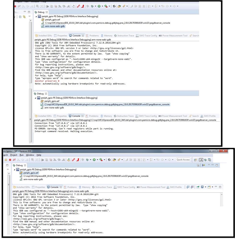

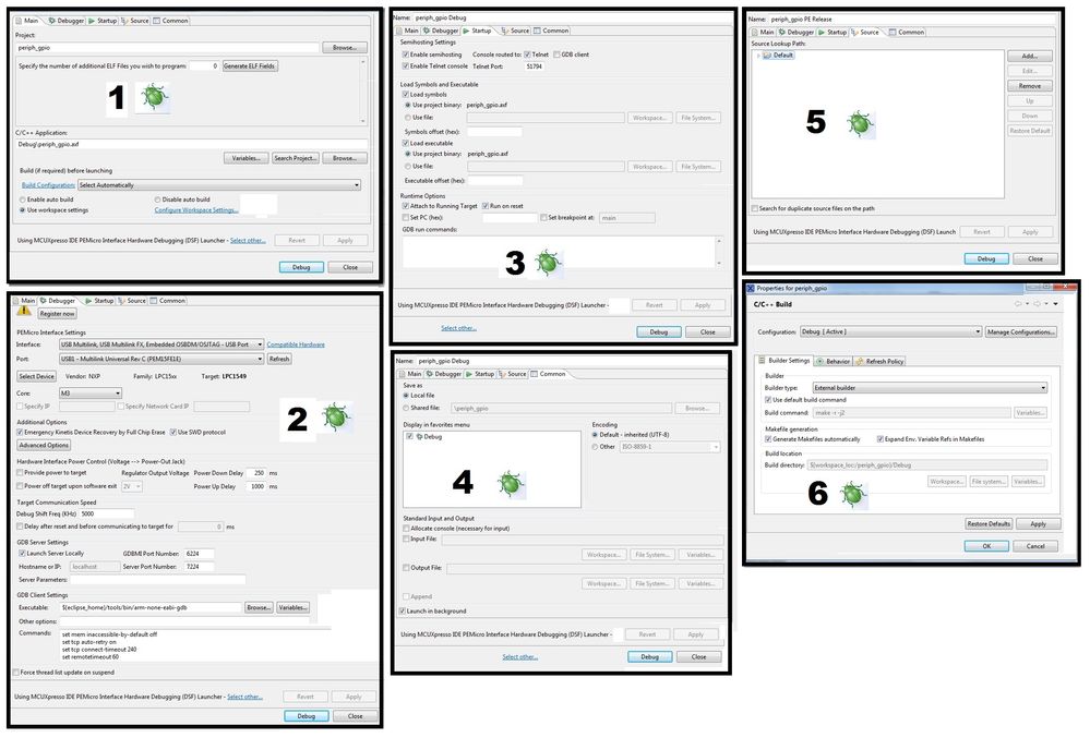

olivierpohu

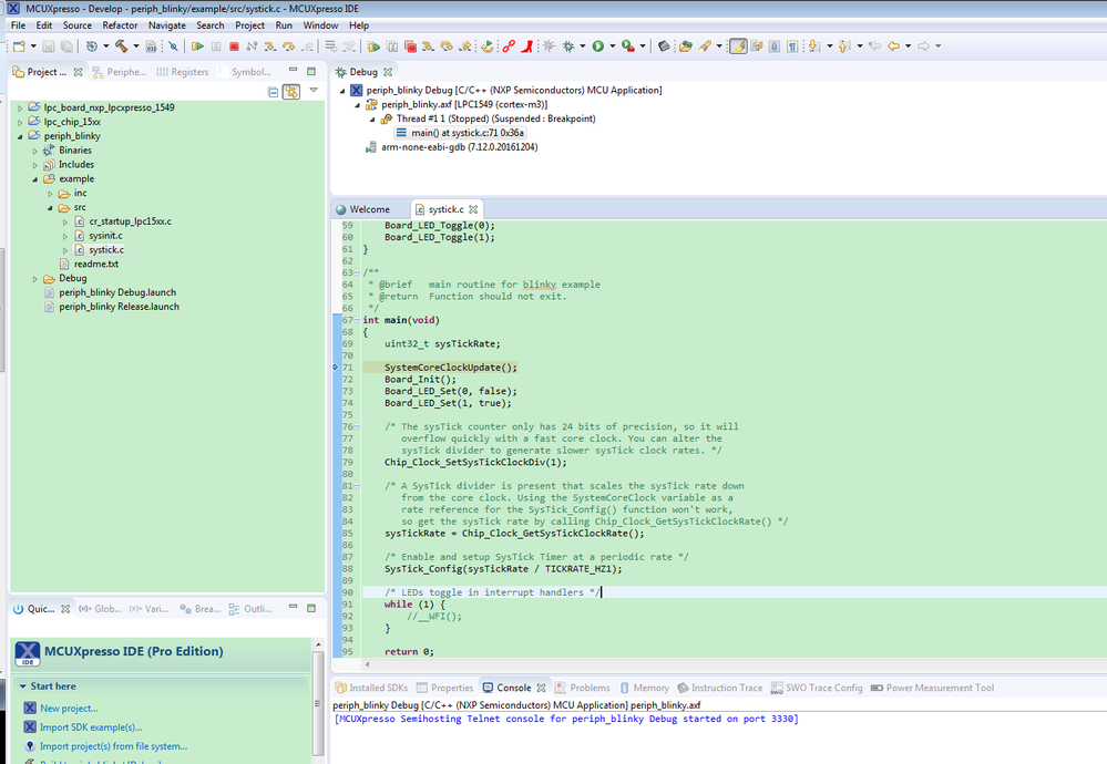

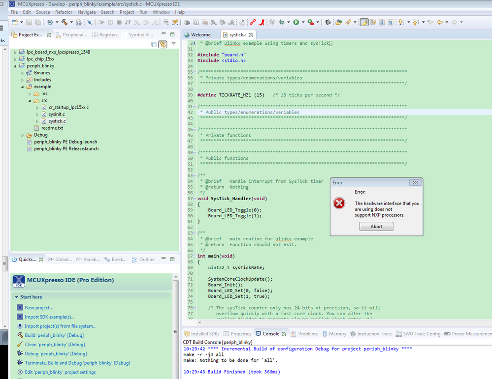

HI Kerry. I haved an other think to do but now i can work on my projet. I have take  The open projet gpio  in lpc1549 Open. i have just modified the pin of the led . but my projet dont flash the Lpc1549. I have buy an other Pe multilink universal but that made the same thing.  i joint to you 2 image . Have you an idee of my Problem ?Config NXP.jpg
and the result of my new PE probe... You can see on the new picture i have no acces to the debug  icon.
Can you help me please ?
9,088 Views
kerryzhou
Hi Olivier POHU,
    From your picture, it seems you already download the code to your board.
   Please click this button:
Where is it stopping?
 You must make sure your PE Multilink can support LPC chip.
Before you enter debug mode, please comment __WFI(); in the code:
Then build, and download the code again.
Kerry

olivierpohu
Hi , i detect the pe probe but my reponse of the ask of debuginng is :
and that  don't fonction ... I don't known where is the problem
Have you an Idea ? ( My file is  main.hex)
