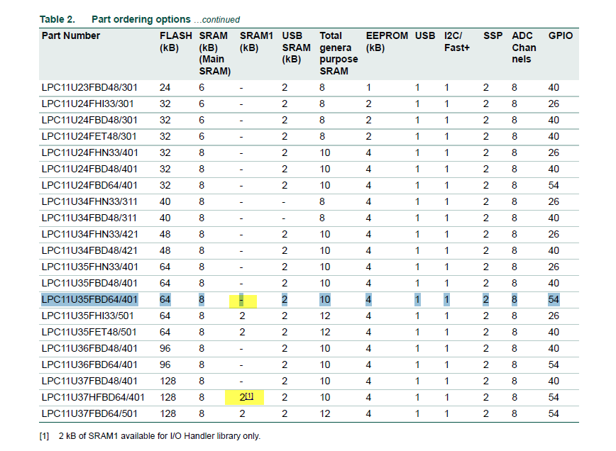

So my question is will code that I write for the LPC11U37 board work on an LPC11U35?
As long as I take care not to go over the memory limits for the LPC11U35.

    Do you mean, your code is work in LPC11U37, but when you download it to LPC11U35, it is not working?
   I suggest, you debug the code, check the details.
   About the LPC11U37 and the LPC11U35 difference.
      If you can't debug the LPC11U35, I suggest you create the lpc11u35 code, and download it to LPC11U37 and debug it, if it is working, then download it to your LPC11U35, please also make sure, the chip is the same package.
