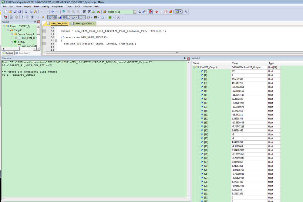

Hi Gaurav More,
    So sorry for my later reply!
   Now, I test your according code, and do a testing summarize:
    I have tested your MDK LPC4367 DSP code on my LPCXpresso LPC43S67 board, I can debug it with CMSIS DAP, the result is:
You can find I can debug it with the CMSIS DAP debugger. I didn't meet any debug problem, so I think you can use our official lpc43s67 lpcxpresso board to test it.
This is the LPC11U68 KEIL DSP project result:
I find these two chip result with KEIL DSP lib is the same, does these data are the correct data which you want?
This is the LPC43S67 DSP code with your LPCXpresso project result:
   Just as you said, yes, this project result is really not the same as the lpc11u68 and lpc4367 mdk dsp lib project.
So, please confirm again, the newest updated question is:
1. LPCXpresso DSP lib have problems in both lpc11u68 and lpc4367
   LPC11U68 enter hardfault, lpc4367 can't get the correct Rfft result.
2. MDK DSP lib can get the correct result with both lpc11u68 and lpc4367
  But you are very care about the execution speed, the LPC11U68 is very slow, but the LPC4367 MDK dsp project can meet your demand.
  Now, actually, the LPC4367 MDK DSP function already works on your side, but you need the MDK(keil) project about the multcore for the LPC43S67, is it correct?
If yes, please refer to our lpcopen code for lpc43xx mdk project, which can be downloaded from this link, I think you can add the MDK DSP lib to the official project.
https://www.nxp.com/downloads/en/libraries/lpcopen_3_02_keil_iar_xpresso4337.zip

     Please check my test result:
You can find the the output data is the same as the MDK now.
Now, let me tell you the details, I downloaded the newest DSP lib from ARM, the source code is:
https://github.com/ARM-software/CMSIS_5/archive/5.3.0.zip
Then, I replace FFT_Code\CMSIS_DSPLIB_SRC\src\dspcode with the newest function code, and change the inc, inc_cmsis files with the new dsp lib, but I still didn't modify the LIB file, because we call the dsp source code directly, then it works correct now. If you want to use the lib, you also can use the newest ARM .lib.
Just as LPCX presso support said in the last post: DSP lib under LPCXpress IDE is very old, we can use the newest lib directly instead of the old DSP lib.
Anyway, I attach my project, and test it on your LPC4367 and check the result.
