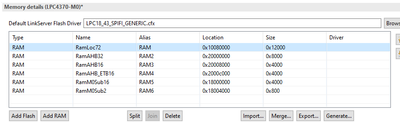

I am using the lpc4370 processor with the Link-2 debug probe. I am trying to create a dual-core application using the M4 and M0APP. I keep getting hard faults at certain parts of the code. Every time I change part of the code the fault happens at a different function however, the address where the hard fault happens is always the same. This is at 0x10088010.
These are the memory blocks that the M0 uses:

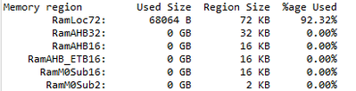

Could the hard fault mean that I am trying to access the memory that is not available? Does this mean that the RAM is too small to hold the program? When building it shows that 92% of the RAM is being used. I thought that this means that it should be just enough but I’m not sure if more memory is taken up when debugging. The debugging is fine when I put the application in bigger RAM and configure it as an M4 application.
Should I ditch the Idea of trying to use this RAM? The only larger RAM of the processor needs to be used by my M4.
Could the hard fault be another issue?
