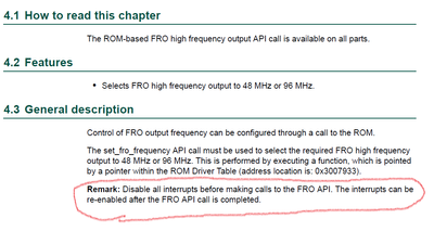

I Run the sample code of USB_CDC_VCOM_BM. In IAR Showing Hard fault Handle error and Accessing Illegal memory address, When Debugging the code. Kindly If anyone find the solution let me know
/*! @brief FROHF clock setting API address in ROM. */
#define CLOCK_FROHF_SETTING_API_ROM_ADDRESS (0x030091DFU)
/*showing Hard fault error when reach this function*/
#define set_fro_frequency(iFreq) (*((void (*)(uint32_t iFreq))(CLOCK_FROHF_SETTING_API_ROM_ADDRESS)))(iFreq)
i'm not sure, why its showing error, SO I attached Example code
##SDK version - 2.13.0
Using ##Lpc54606j256 microcontroller, IAR TOO

Regarding your question of hard-fault error when the code is executed.
Pls check the following items:
1)disable interrupt before you call the api function, after calling, enable interrupt.
__STATIC_FORCEINLINE void __enable_irq(void)
__ASM volatile ("cpsie i" : : : "memory");
__disable_irq();
set_fro_frequency(96000000);
__enable_irq();
2)enable ROM bit in SYSCON->AHBCLKCTRL0|=1<<1; in this way, you can call the ROM code
3)Because set_fro_frequency(96000000); function configure the FRO to output 96MHz clock, it is unnecessary to configure the SYSCON->FROCTROL in application code.
Pls have a try
