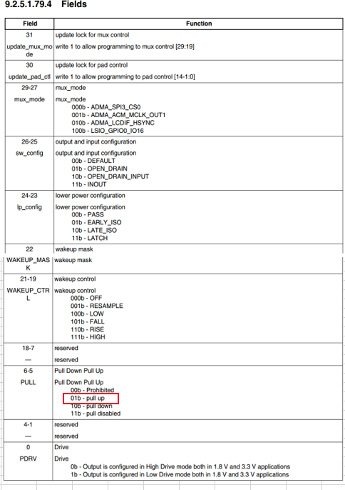

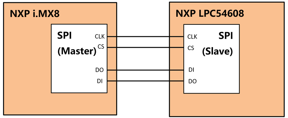

We consider i.MX8 as the Master SPI and LPC54608 as the Slave SPI, and the communication with CS is effective at low voltage levels. The CS pins of i.MX8 and LPC54608 are pulled up by default. When i.MX8 needs to transmit data to LPC54608 through SPI, i.MX8 will configure the CS pin to output 0.
CS configurations of NXP LPC54608CS configurations of NXP LPC54608

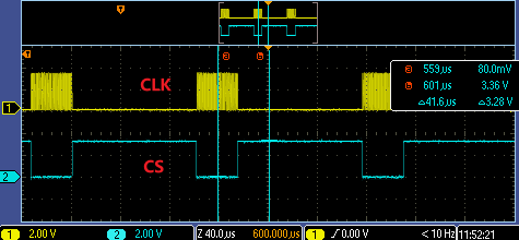

Currently, most of the 18000 machines we tested have normal SPI communication, but there are still 20 machines that may experience communication issues between i.MX8 and LPC54608.
The problem is that LPC54608's SPI interrupt cannot enter. Using an oscilloscope to measure the machine with SPI communication failure, it was found that LPC54608’s DI pin can receive data, but LPC54608’s DO pin cannot send data. I would like to ask for your insights.
SPI ConnectionSPI Connection

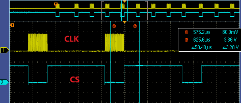

We tried to set LPC54608’s CS pin to pull down, and surprisingly, SPI communication became possible between i.MX8 and LPC54608. However, it is puzzling that whether LPC54608’s CS pin is set to pull down or pull up, the voltage waveform of LPC54608’s CS is correct. For some unknown reason, when LPC54608’s CS pin is set to pull up, communication between i.MX8 and LPC54608 of this machine cannot be achieved.
LPC54608 CS pull_downLPC54608 CS pull_downLPC54608 CS pull_upLPC54608 CS pull_up

When the SPI of LPC54606 is configured as spi slave mode, both the /CS and SCK pins of the LPC54608 are in input mode, the SPI master generates the signal to drive /CS and SCK. If the master drives the /CS in push/pull mode, it does not matter whether you configure the /CS pin of LPC65408 in pull up or down mode, it does matter when the /CS pin of LPC54608 is float. BTW, from the two pictures you gave in both /CS pull-up and down, I do not see any difference for the waveform of /CS signal.
From theory, any /CS low and SCK toggling will make the slave SPI work, but if you configure the /CS in pull-down mode, it can solve the SPI issue, it is okay.
