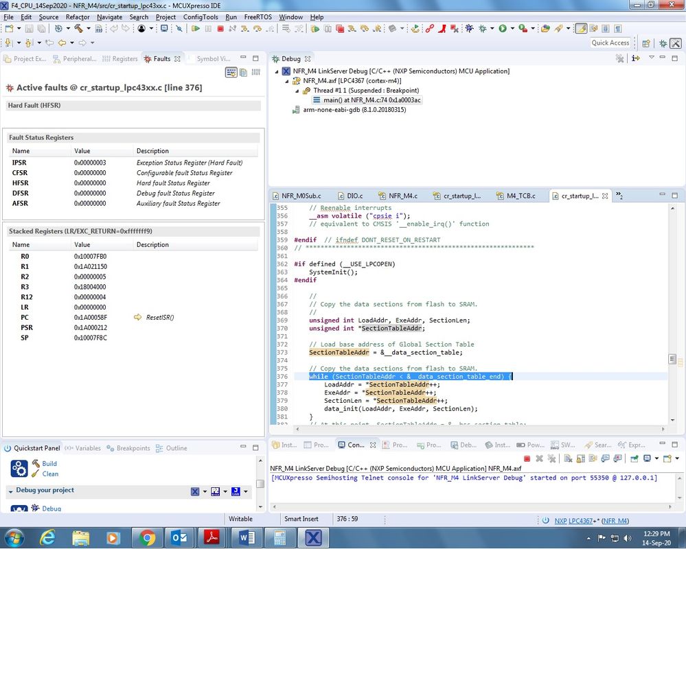

I am using LPC4367JBD208E controller for one of my product development. I am using MCUXpresso 10.3.1_2233 for the application development. I have developed the application and while debugging the same I faced following error.
This error comes while I was  lauching the application for debugging, and as per the information given I checked the line 376 in cr_startup_lpc43xx.c As shown below.
But I do not understand the significance of the error mentioned since at one side it is going to the main .c but on the other side it shows this error.
please Explained. one more information is that currently the RAM cionsumed is 85.19% of 32KB assigned memory.

I am a bit confused by your environment. I had been more involved with other MCU families and toolchains, and only recently got into LPCs again.
The startup file name "cr_startup*" suggests it belonged to Code Red, basically the predecessor of LPCXpressoIDE. Is it older legacy code, ported to another MCU ?
The hardfault seems to happen while copying initialzation values from Flash to RAM. I would check the actual address where it happens, perhaps in instruction step mode. And then crosscheck with the map file.

The back ground is that previuosly in used LPCXpresso 8.2 version where i was developing the application . But later I got to know that the support for it will be limited and they have now shifter to MCUXpresso. They suggested to use MCUXpresso. So i am using MCUXpresso 10.3.1_2233 and there i imported the project from the LPC Xpresso to MCU Xpresso IDE.
Does it makes any difference? Since then I am working on the same project. I just kept the below mentioned settings as it is.
and then proceed for the development.
Reagrding the actual address check how to do that while debugging?
Please let me know and then i will check, Also let know the other query response, mentioned below,
