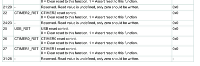

In my opinion, there is a bug into syscon_5411x.h  files when defining CHIP_SYSCON_PERIPH_RESET_T enum type.
From the datasheet, you read this:

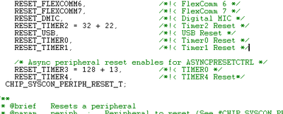

But the include file is:
For making it working, it is required to change definition of RESET_USB to:
RESET_USB = 32 + 25, /*!< USB Reset */

Hello carlobramini,
Yes, you are right, thanks for your sharing.
