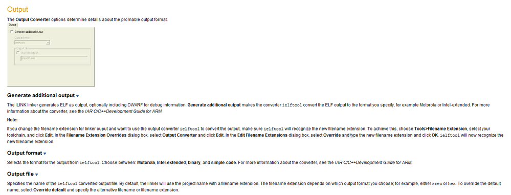

Hi, I'm working with NXP LPC4367 in IAR Embedded Workbench. The firmware output file is in Intel-hex format with size 1MB.
I want to do IAP (In-app programming) to update code to Flash Bank A  and this bank only has 512KB.  Is there a way to generate hex firmware format instead of Intel-hex?  Thanks for the help.

You can learn the way of selecting output executable file by referring to the following figure.

Output converter "binary" is the correct solution I was looking for. Thanks.
